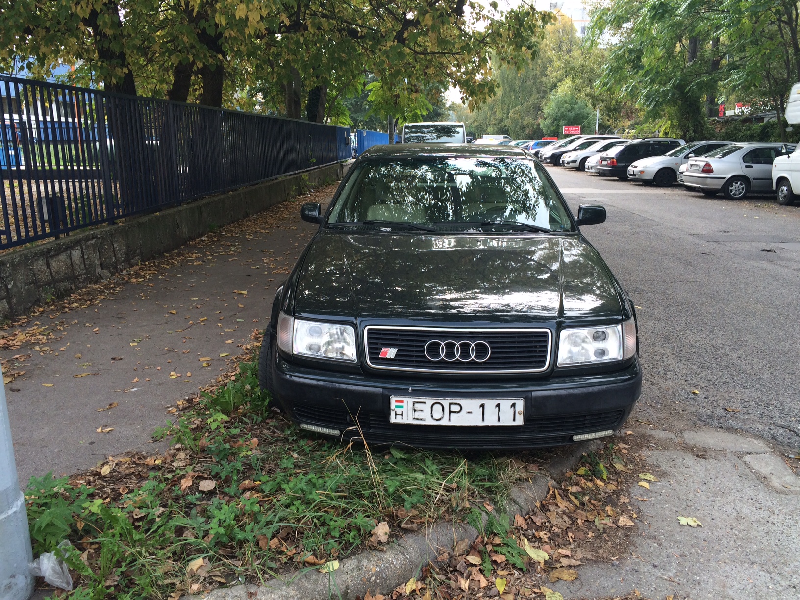

End of September 2015 I started looking for a nice base for my project. At the time there were 3 cars up for sale in the entire country (I'm in Hungary) 2 of them were avants so I had 1 choice and I went with it. I got my 1994 100 S4 2.2T.
Outside looks great the only flaw it has on the exterior was the black trim not being perfect and the taillights.
Mechanically there were a boat load of problems but the car idled fine. And it worked for getting from A to B reliably.
The exhaust manifold had at least 6 cracks.
The wastegate was tampered with and the diaphragm was dead
The turbo was shooting oil all over the place
it had an after market alarm
it had an automatic gearbox
