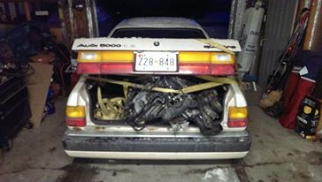

Let's start with some good old 5cyl content: the $500 5k of win bringing the engine home
The Engine.jpg (18.08 KiB) Viewed 25909 times

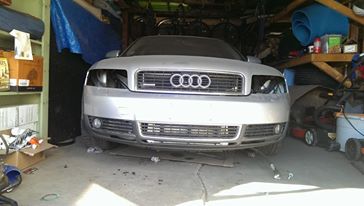

The shell losing it's 3.0l in the rents garage
The Shell.jpg (11.81 KiB) Viewed 25909 times

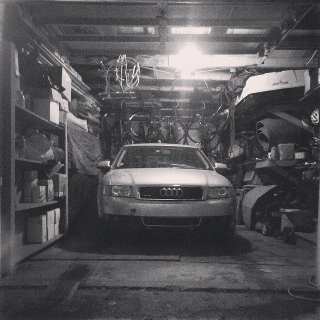

Moved to my house! I live downtown and got really lucky and have a garage and relatively big driveway
Burlington Move.jpg (103.48 KiB) Viewed 25909 times

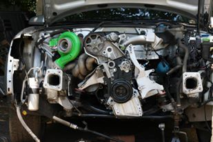

Clean engine bay
Engine Bay.jpg (18.93 KiB) Viewed 25909 times

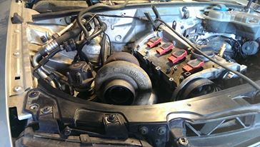

Gromit with the 7 blade HX35
Holset Gromit.jpg (23.5 KiB) Viewed 25909 times

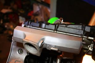

Manifold mockup
Manifold Mock Up.jpg (23.55 KiB) Viewed 25906 times
Manifold Mock Up 2.jpg (11.85 KiB) Viewed 25906 times

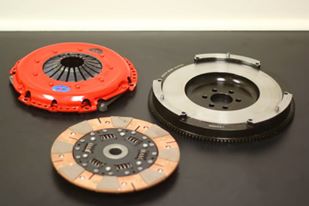

Custom 6 puck Southbend clutch and 17lb steel flywheel

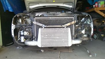

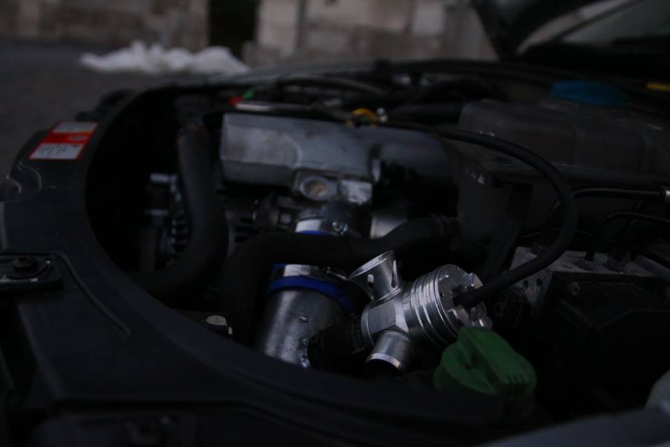

Intercooler install
Intercooler 2.jpg (16.8 KiB) Viewed 25906 times

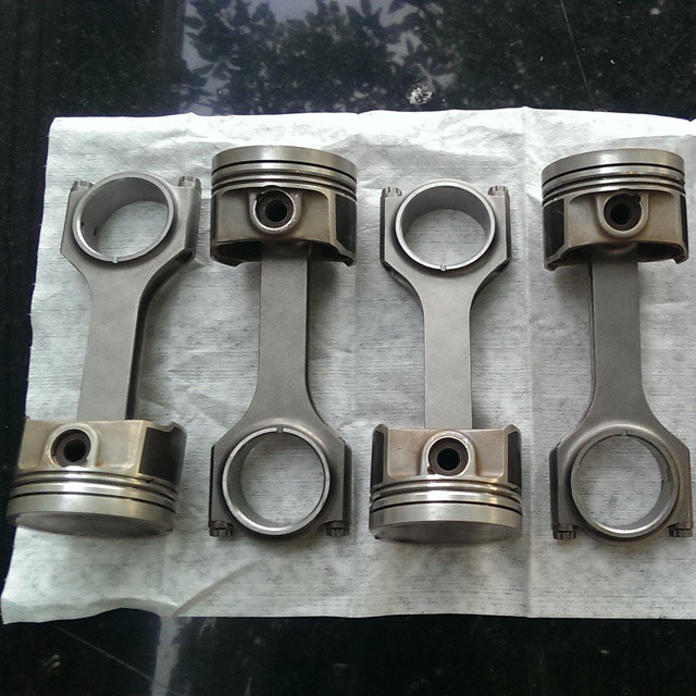

AEB pistons and Scat rods
Pistons and Rods.jpg (105.16 KiB) Viewed 25905 times

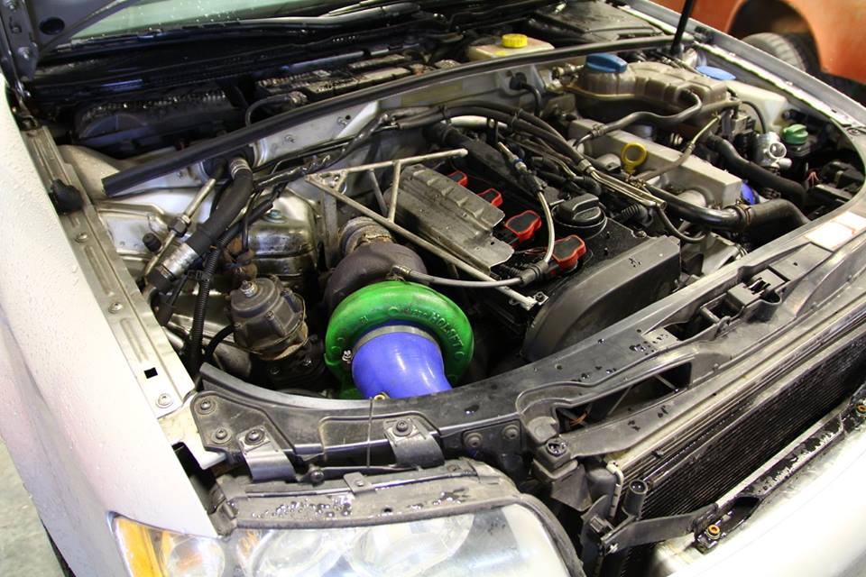

Coming together!
Artsy Manifold.jpg (15.58 KiB) Viewed 25905 times
Across Manifold.jpg (12.21 KiB) Viewed 25905 times
Money Shot.jpg (18.24 KiB) Viewed 25905 times

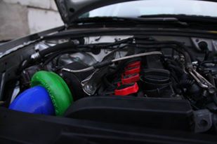

Real Bay.jpg (109.88 KiB) Viewed 25905 times

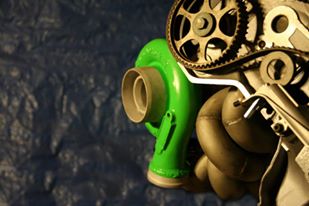

The 12cm was too laggy so I switched to a .63 Tim's Turbos hotside and it was much improved
New Hotside.jpg (17.4 KiB) Viewed 25905 times
