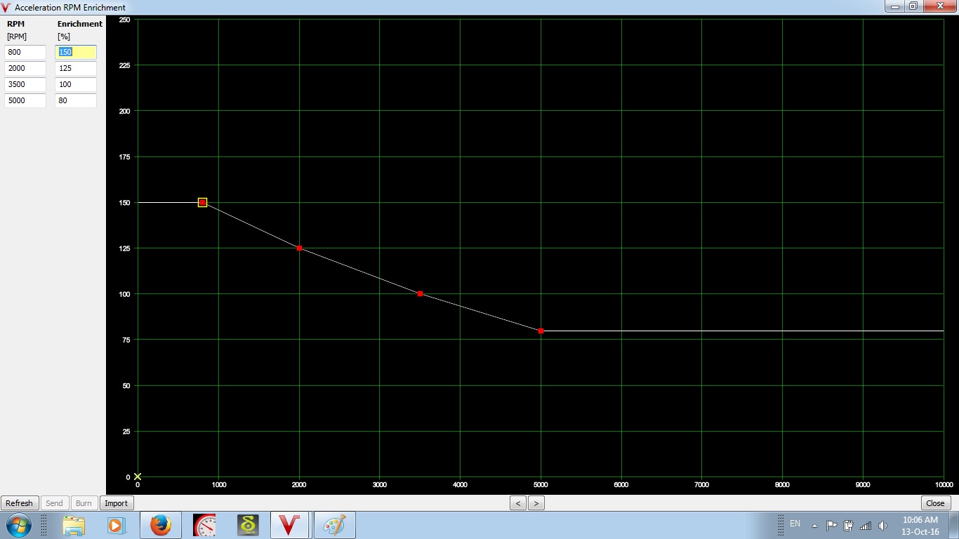

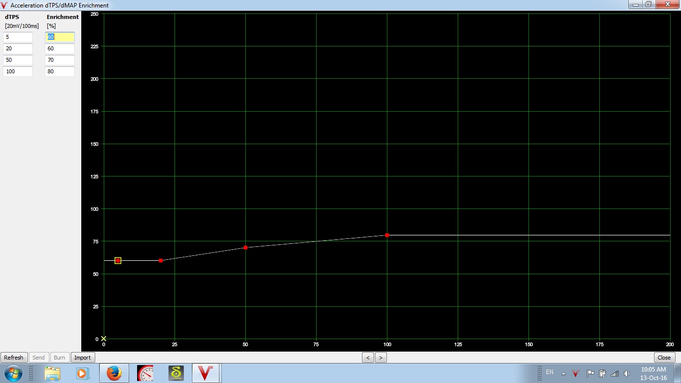

Last night, I bumped up the dTPS and the RPM enrichments a lot. That actually worked. It then went quite rich so I am getting somewhere, I think. It was much more responsive. I have attached pics of the settings I used last night. I turned it down a tad because it dropped down to .76 or moe and did a rich bog.

I should add that I'm still learning how to interpret the log. I understand how dTPS works and know that there is a delay of about 0.3-0.5sec before something happens. IIUC accel RPM adds fuel with (quick?) changes in RPM. Not sure how to see that. I guess I need to log separately. One log with RPM only and another with dTPS only.
Re: Acceleration enrichment, driving me crazy
To be honest I don't use the rpm enrichment. I would just tweak the dtps/dt until you eliminate any spikes. That should be all you need.

loxxrider wrote:To be honest I don't use the rpm enrichment. I would just tweak the dtps/dt until you eliminate any spikes. That should be all you need.
I see! Do you put RPM enrich at 100 or 0? The worst area where I have lean bogs/chokes is the 700-1700rpm and 20-76kpa cells. Decel going to accel.
Very hard to tune properly. I read this write up ( http://www.enginebuildermag.com/2012/01 ... ooth-idle/ ) many times and use the tips. They helped.
In that case you could use the rpm enrichment between the two rpm you mentioned, but it's really for taking dtps/dt fueling out a bit at higher rpm. It isn't needed as much there. What happens if you add more fuel in those parts of the dtps table?
I would just leave your rpm enrichment as they are for now until you notice problems revving while coming off of high rpm.

I don't really have (lean) problems at high RPM (4000+). Its the heavy traffic driving at low RPMs. It's probably because I don't have an idle control valve. I am waiting for the VEMS US boys ( https://www.facebook.com/VEMSUS/photos/ ... =3&theater ) to finish developing a new PCB specifically for the two-way VR6 TB IAC motor.
With AC on, my engine idles at 670, w/o AC 1050.
It was a lot better today, though. I will try removing RPM enrich and just use dTPS. I forgot to ask: What happens when there is negative dTPS?
Does it take fuel out?

loxxrider wrote:. What happens if you add more fuel in those parts of the dtps table?
It works well at mid to high rpm.
