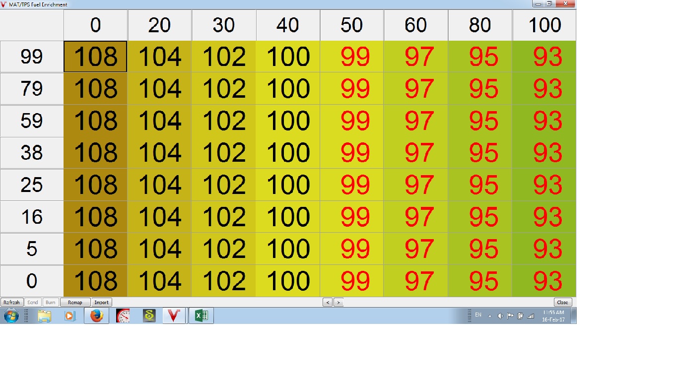

Yeah, its not too bad. If I start with an IAT of 40c and go from 100kpa to 200kpa for 10seconds, IAT goes up to 47c.UrSobsessed wrote:48-50 IAT doesn't sound high to me for 25c ambient if you're in traffic, especially stop and go. Others may disagree, but my temps go up driving around in the city during the summer. When cruising, they go down to 20-30c. I've been using the supplied curve with the firmware for the 1.8t sensor.
I have been adjusting the MAT/TPS table the last few days. Can't believe I ignored this for so long
Always expected my EGO correction to take care of things. Silly me. Every time after a run, I am adjusting my VE table up and down in the same cells. Drives me up the wall.
Still, I have been fine tuning my warm up enrichment, now the MAT/TPS fueling. I was reading some posts on the Guild of EFI FB page yesterday and realized that of course IAT has an influence. I am an idiot
I am using 40c now as my benchmark, because that is my usual IAT when engine is warm. Put my MAT/TPS table on a linear slope. Just watched my hot idle IAT sitting at 52c and 1.04lambda, inj PW was 1.6ms, which is the lowest stable PW for 630cc Dekas. Adjusted the table and went right back to 1.0. Win. Learning by doing takes a long time...
Awesome quote from a dude of the fb page: "Scotland, we have really dense air."
- MATTPS.jpg (253.96 KiB) Viewed 45789 times

Re: Fueling table viable year round?
That IS an odd table. How did you come up with this?
I've only been in the middle 4 column range
You can probably disregard all but those and the -10 one I think. Just the nature of the beast I guess lol
