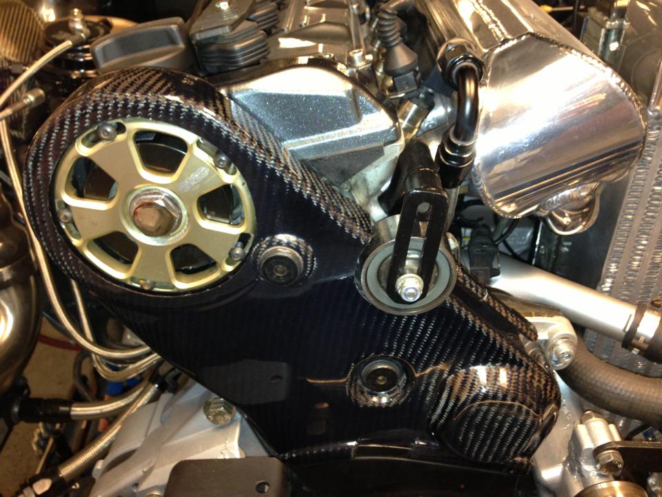

Anybody run the bumped out efiexpress cf cover over an Autotech 16v gear from 034? Also if so, are you running it with extra spacers beyond the long steel ones, rubber grommets, and the Alan head nuts?
Re: Timing belt gear upgrade mileage question
Aron designed the "bumped out" cover to fit the adjustable units such as the Tomis cam gear. If yours is similar in profile, it should fit fine.

Ya that's kind of why I'm worried. I didn't know which gear it was made for. I'll have to scavenge the Googles for more info and maybe some profile views if available. Thanks for the heads up, PRAY

Those look awesome! One thing that's killing me is not being able to find this build thread using reverse image searching :wah:
I'm being told that the efiexpress cover should fit over the 16v Autotech gear since it's not terribly unique in design from the others available.
My main concern was really it's center section since when I would push down on the cover, every part would flex except that center area. It's supposed to fit fine though so I will do a start up later today with the cover nuts loose and slowly tighten them while observing any noises.
I am surprised how common the belt "flapping" against the inside cover is. I would like to diminish belt damage from it before changing the TB components of course. Maybe "my belt needs cinched up slightly" :hammer: between the cam gear and water pump lol

I already did and it didn't fit and I had to modify the living fk out of it only to still have it rub occasionally as well as cracked in a spot lol. Thanks though. At least we have an answer down now.
