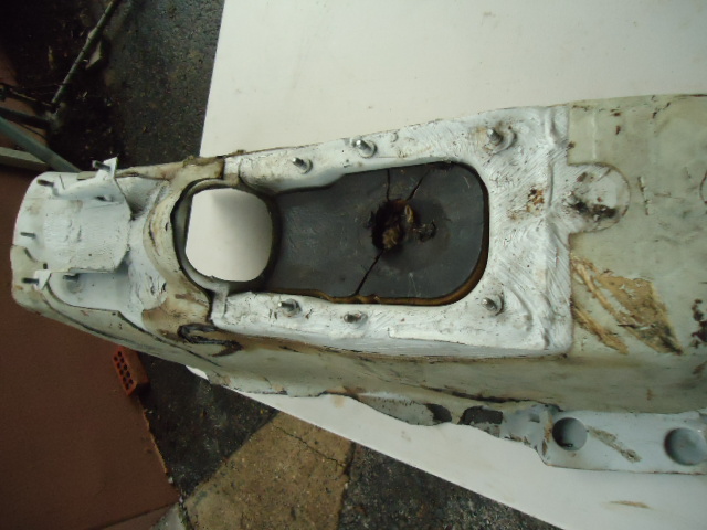

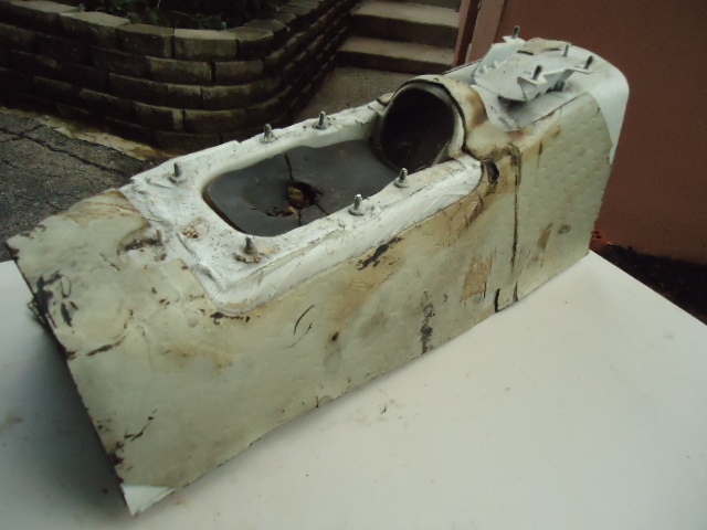

I have a trans tunnel cut from an UrS4 if you did not want to cut up your donor car.
- Trans tunnel 3.JPG (121.87 KiB) Viewed 28279 times
- Trans tunnel 1.JPG (116.84 KiB) Viewed 28279 times
