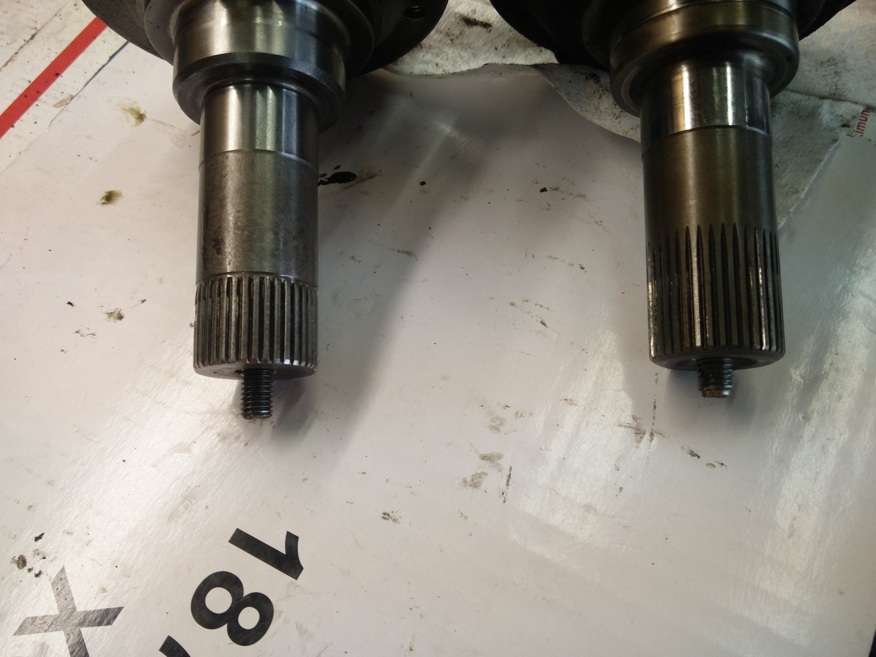

Axles
The axle cups are the part which spline into the transmission, which you physically bolt the axles to, shown here:
Audi used 2 different size internal splines on their transmissions, as well as two different sized axles. The large spline is a little over 29mm, the small size is a bit smaller(I didn't measure). The large axle size, seen here, is 108mm:
The small axle size , seen here, is 100mm:
The 01A in all the b3 cars uses the small spline with 100mm axles. The 01E uses large spline and 108mm axles, meaning the transmission will not bolt up as-is to the smaller axles in a B3 car. Luckily, the 4000 quattro used an 016 transmission, which uses large splines, and the car itself was fitted with 100mm axles. You need these axle cups if you want to use an 01E with your stock axles.
(I believe the B3 cars also use this size cup on the right rear of the differential, so if you have a couple spare B3 diffs, you can use those)

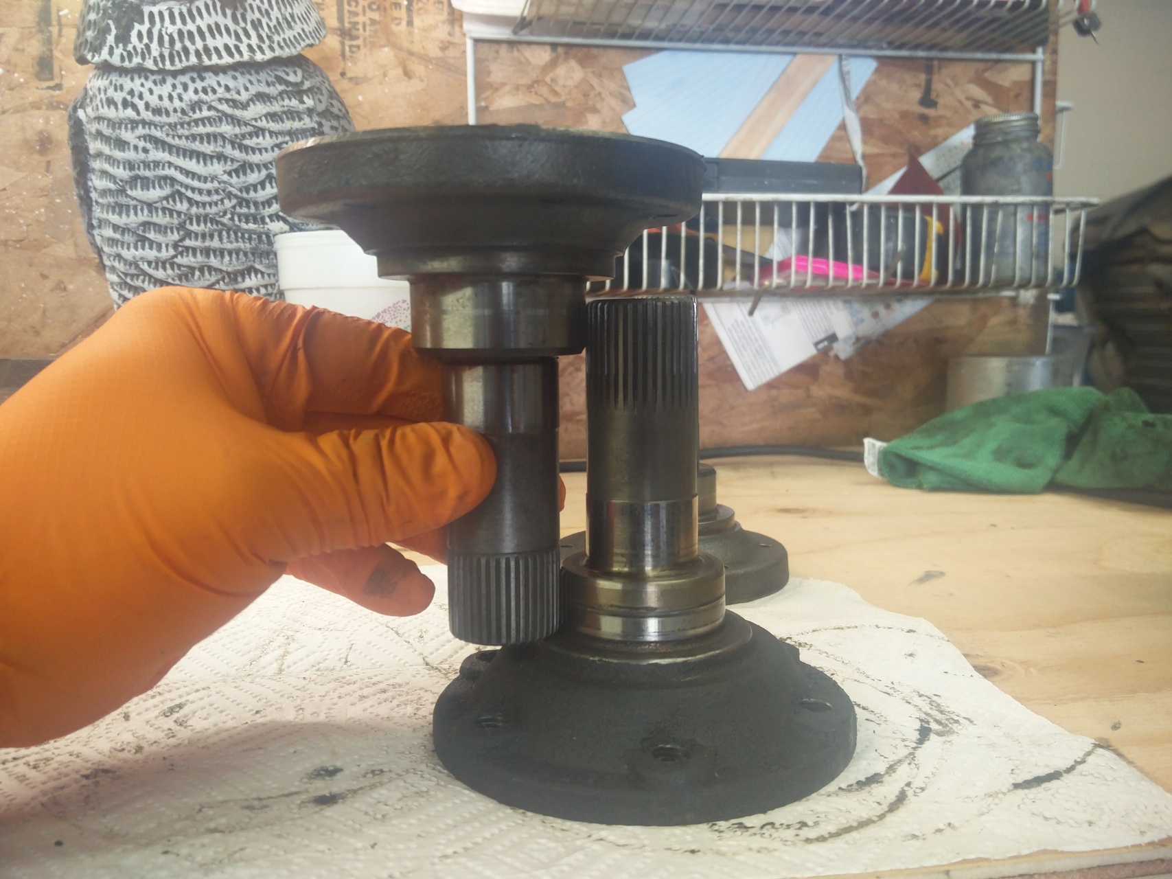

As you can see here I have the 01E axle cup comparing it to the axle cup from the 4000q.
Same internal spline size:
Different axle sizes:
These fit with no modification into the 01E, but keep in mind you need the bolts from the 4k! The bolts are not the same, you cannot use the bolt from the 6 speed, and the 01As don't have any bolts, so be sure to keep the bolts from the 4k! You can see the differences here:
The 6 speed bolt is the shorter, square shoulder bolt. If you try to use the 6 speed axle cup bolt with a 4k axle cup, you won't even make it out the back of the axle cup, shown here:

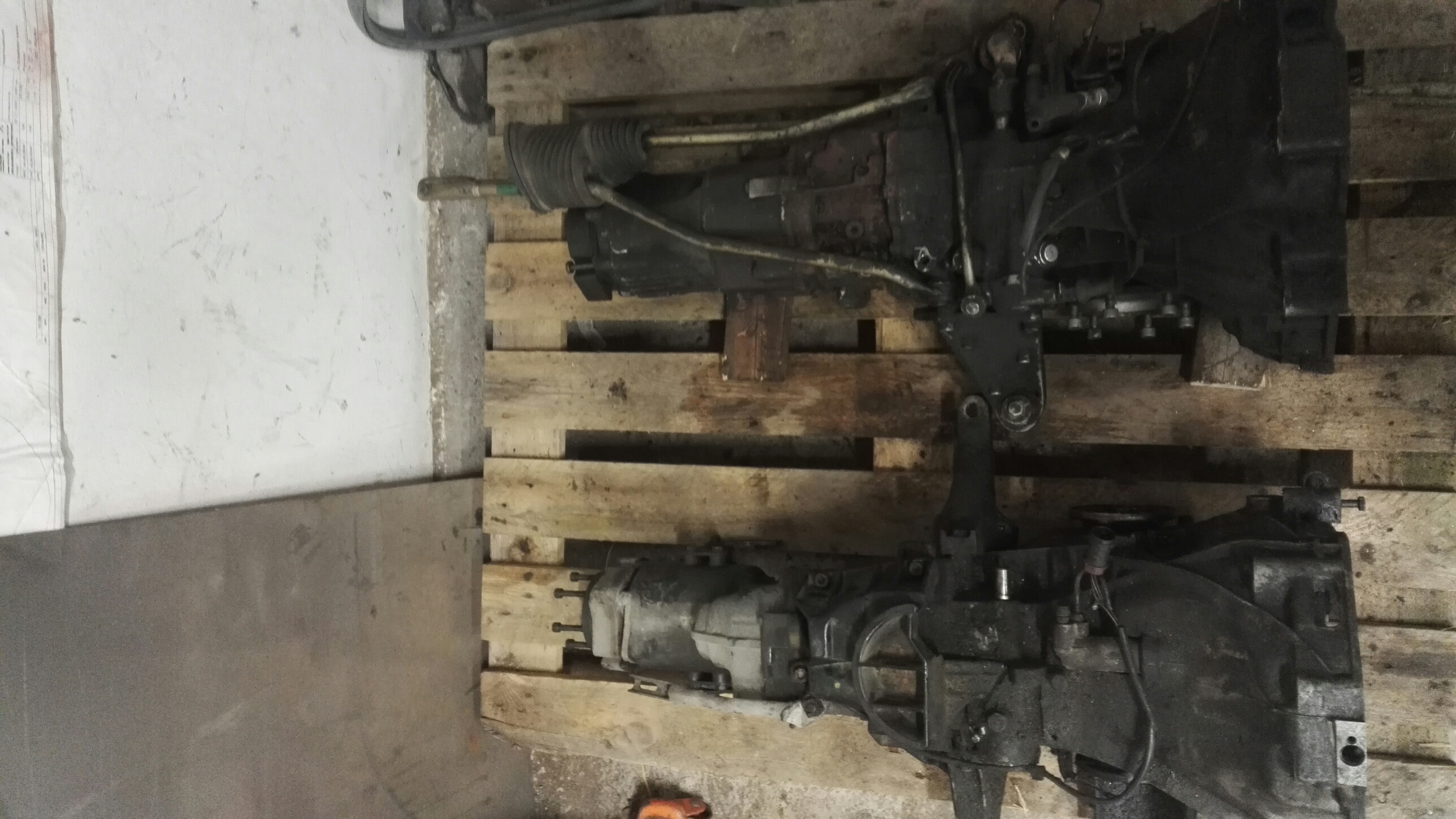

Transmission
It's worth mentioning that the UrS cars came with an 01E, but it was a 5 speed. People can and do swap those into B3 cars, but this post is specificlly about the 6 speed version which was found in a few cars. People mostly associate the 6 speed 01E with the b5 S4, but it was also found in the C5 A6 manual, as well as the C5 allroad. Unfortunately, the allroad does NOT have 4.11 front final drive, so you cannot use it as-is in your B3. The 6 speed 01E was also used in the RS2, but those are hard to find and quite expensive, so chances are good you'll be looking for eiher a B5 S4, or a C5 A6 2.7t. I found mine in a local picknpull. It cost $99 plus a $30 core, with a 30 day warranty.
Here is an 01E(top) next to an 01A(bottom):
Note the 01E uses a stabilizer bar which bolts to the floating shifter assembly in a B5/C5. I won't be using this, so it's simply removed and discarded.

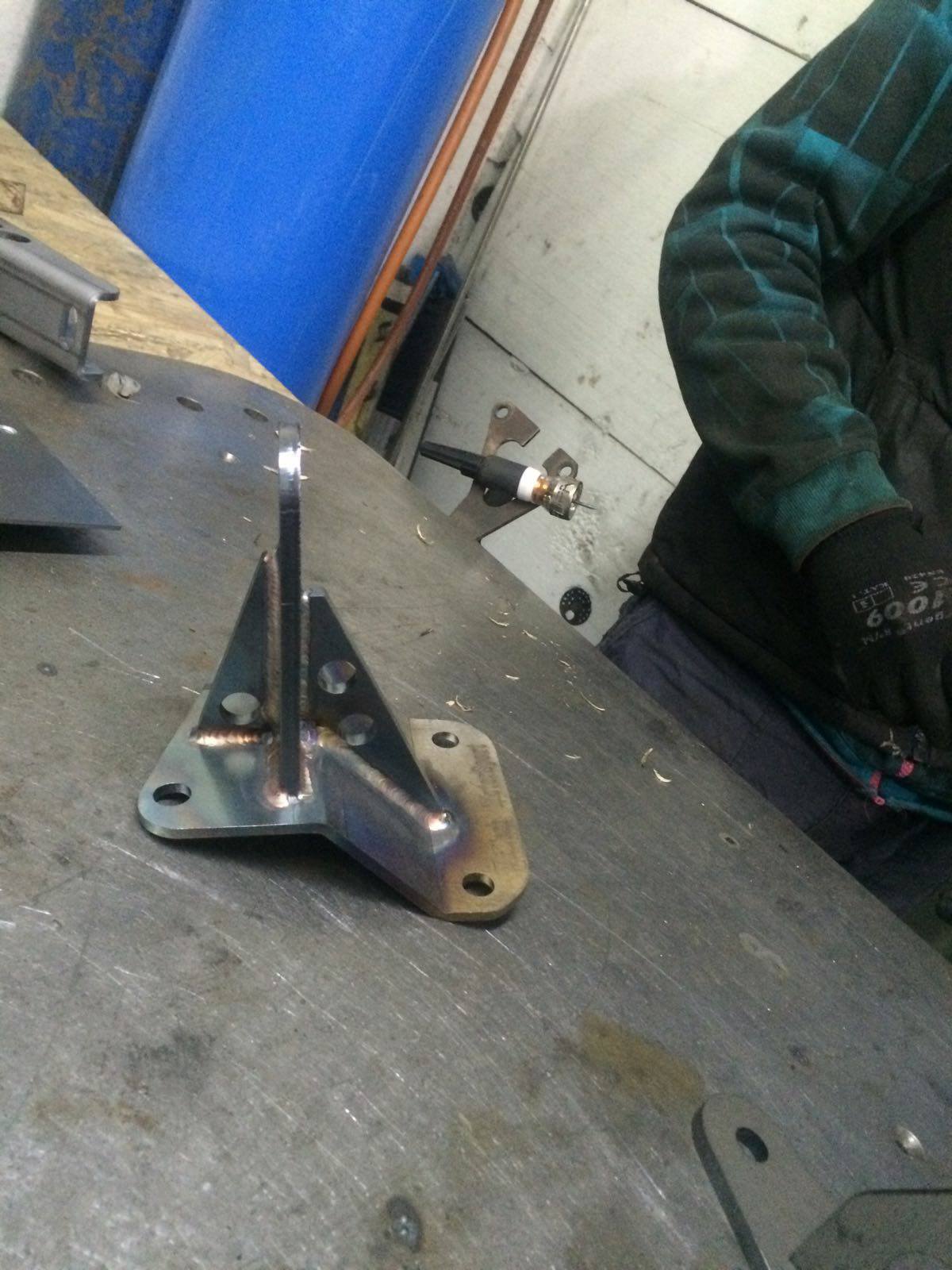

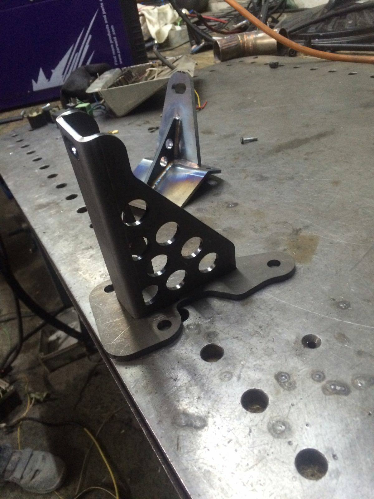

I ended up making my own mounts out of 3/8 steel. Total cost was under $20. $12 for steel(only used half of a 12x24" sheet, and $8 for a 10 pack of harbor freight cutoff wheels for the angle grinder. Granted, the mounts aren't going to win any beauty contests, but they fit nicely, and should be able to take the abuse. Mounts were made with a drill, an angle grinder, and a shitty old welder.
Couple progress pics of the mounts.
Here it is in the car.

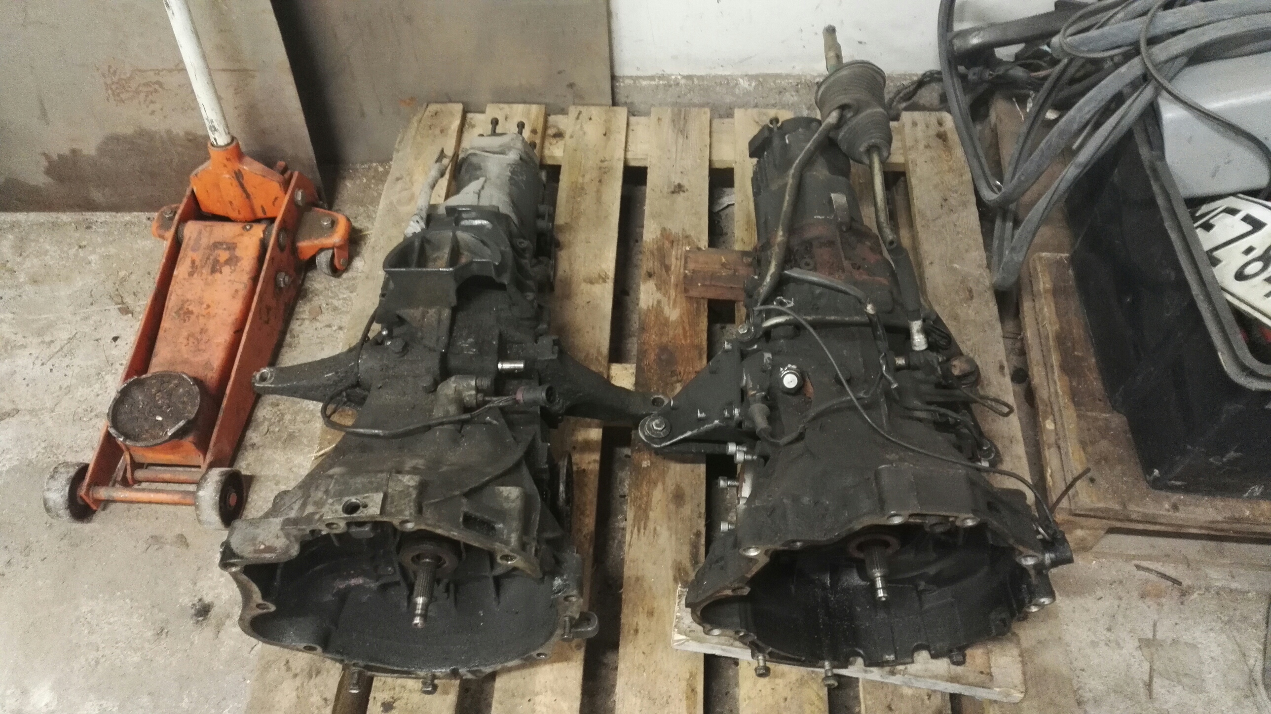

Just as a reference and an add-on to good photos above, 016 vs 01E photos
016 below, 01E top
016 below, 01E top
016 left, 01E right
016 left, 01E right

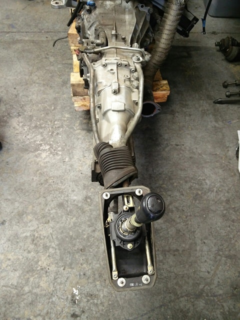

Hi guys, I'm working on this as well.
Trying to fully understand my options for the linkage.
I have the B5S4 linkage and shifter box - so is it easiest to use that whole setup? I'm assuming the cup flip isn't needed for this but I read I need to shorten both the selector rod and the stabilizer bar by about 1 1/4" is this true?
or I can use the B5 S4 linkage and do the cup flip and use my B4 shifter box (and my JHM short throw shifter)
Also I've read that you the stabilizer bar causes clearance issues but it doesn't seem to be mentioned every time - just occasionally. Some people eliminate them but Chris is saying above to keep it to avoid missing gears.
What's everyone's opinion?

I am running the selector bar only, with the cup chopped off and the 01a cup butt welded to the 01e selector rod. I took out about 1.25-1.5" of length on the selector rod. No stabilizer bar. Shifts well. I am using the OEM b3 shifter assembly, so its got a bit of slop like they all do. I tried my setup with the mk1 vw shifter cup, but the geometry was wrong somehow, and I went back to the b3 shifter. The entire shifter is rotated 180 degrees so the reverse lockout is in the right place.
Posts: 2142
Re: 01E swap into B3
If you have very firm engine and transmission mounts, you don't need the stabilizer bar. I have never run one, and have not had issues. I have poly mustang trans mounts up front and stock trans mounts with large washers to limit travel.
