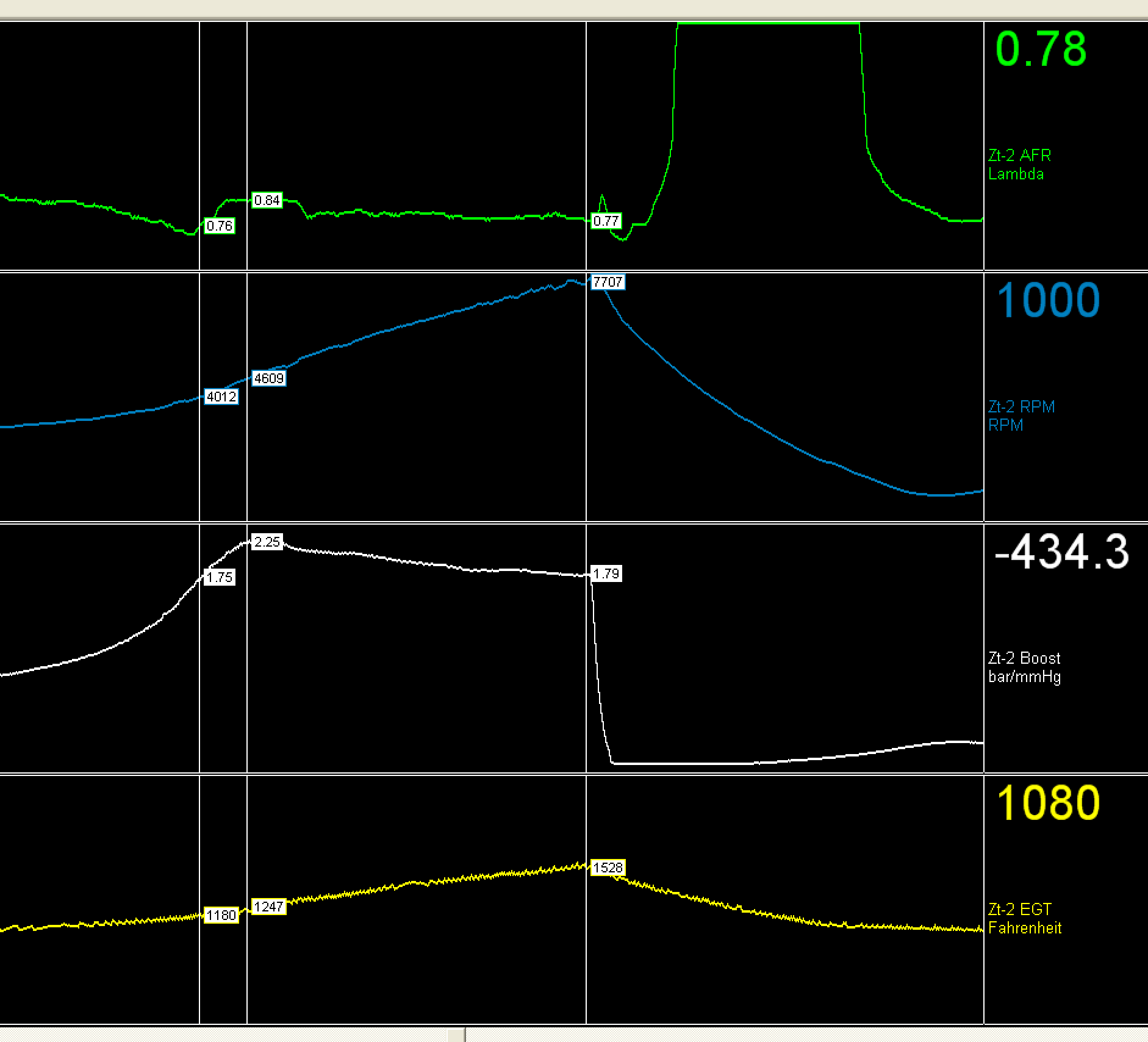

Can you provide any logs or data for boost profiles in 3rd or 4th gear, Jim?
Interested to see when your car starts to come alive.

I run a quick spool valve and t4 divided housing. It spoils fast. In 6th gear it will make 1bar by 3300 rpms. 3rd gear is around 4300 for full boostversacehobo wrote:Can you provide any logs or data for boost profiles in 3rd or 4th gear, Jim?

How many kPa is full boost?

2.2 bar on 07k cams
1.85 bar on ttrs cams
Here is a 3rd gear dyno pull on the stock 07k cams and valves.
