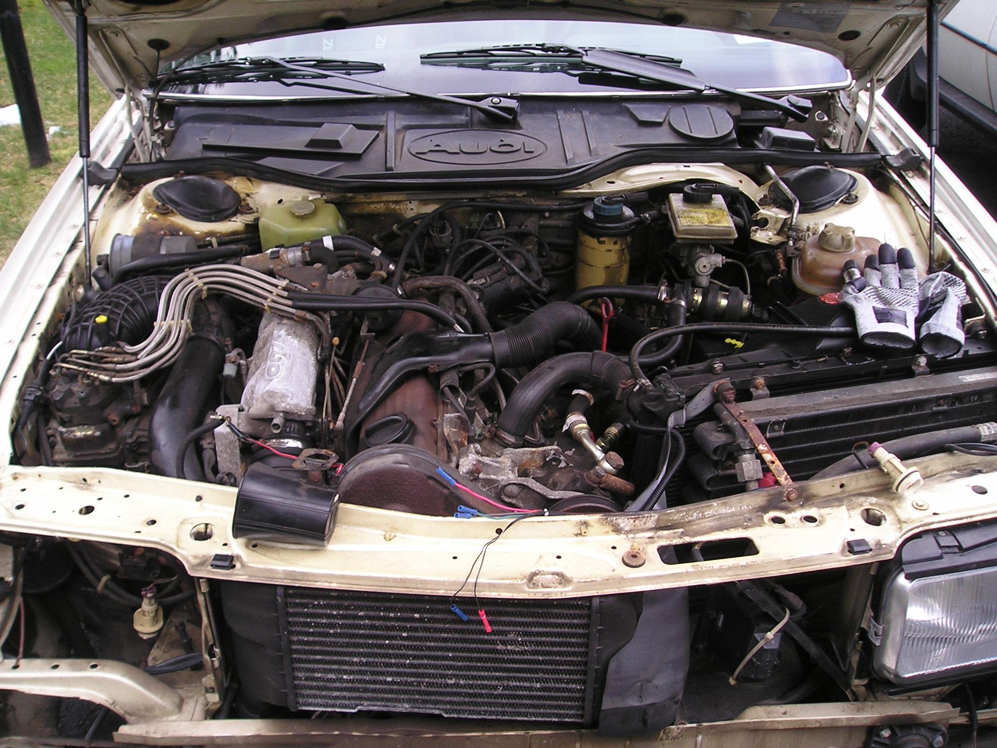

The beginning of the EFI conversion.. 2012
More details later...

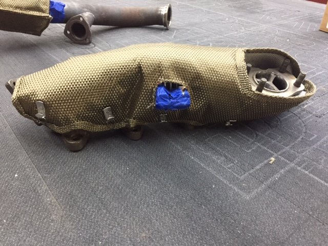

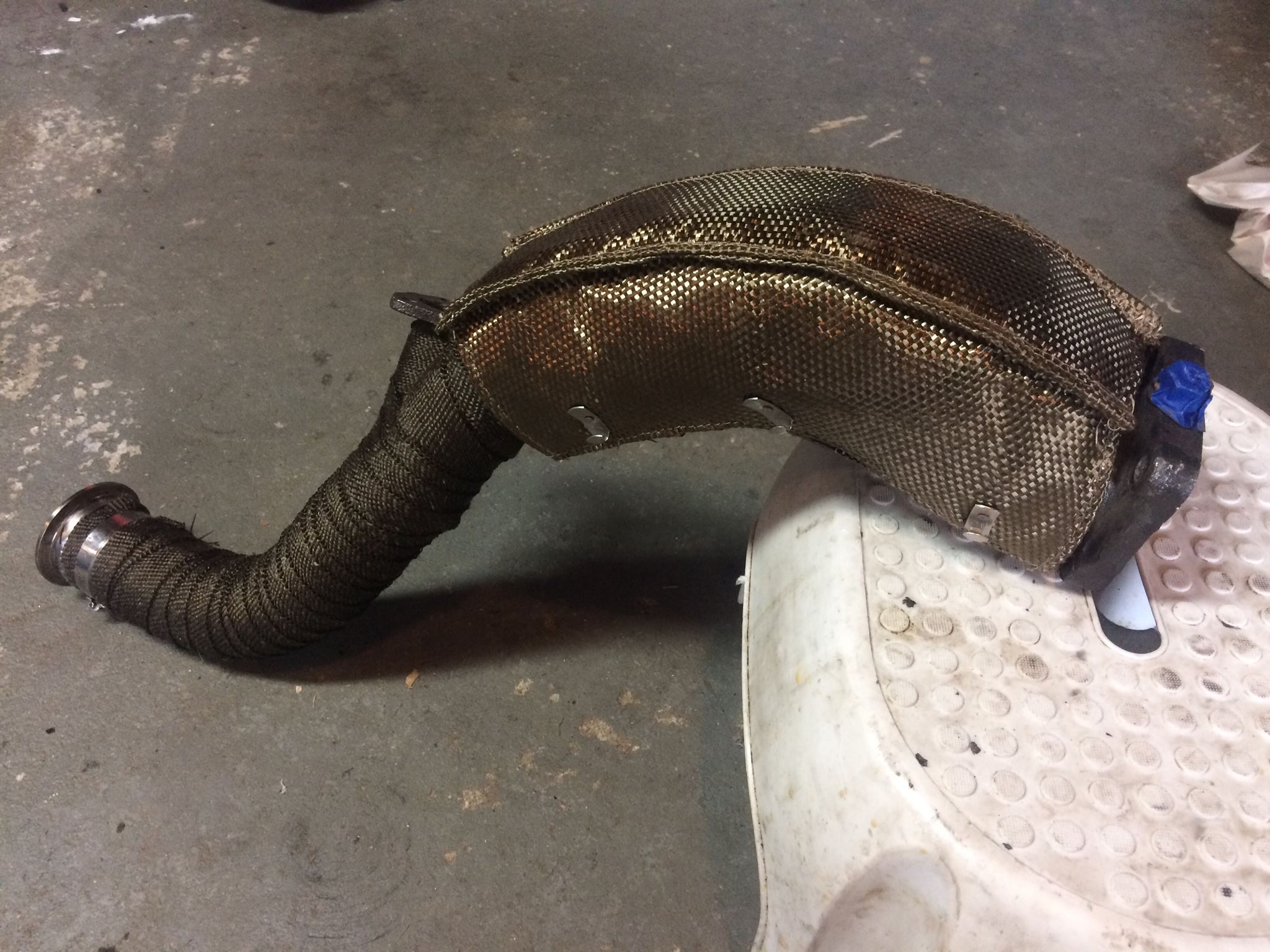

Among the long list of things to hate on the 20v for is heat control... or the lack there off...
My final attempt at this came together during the winter 2016...
NOS two piece EM
Retained the phenolic intake spacer
New custom lava manifold blanket
Custom lava stuff dp blanket

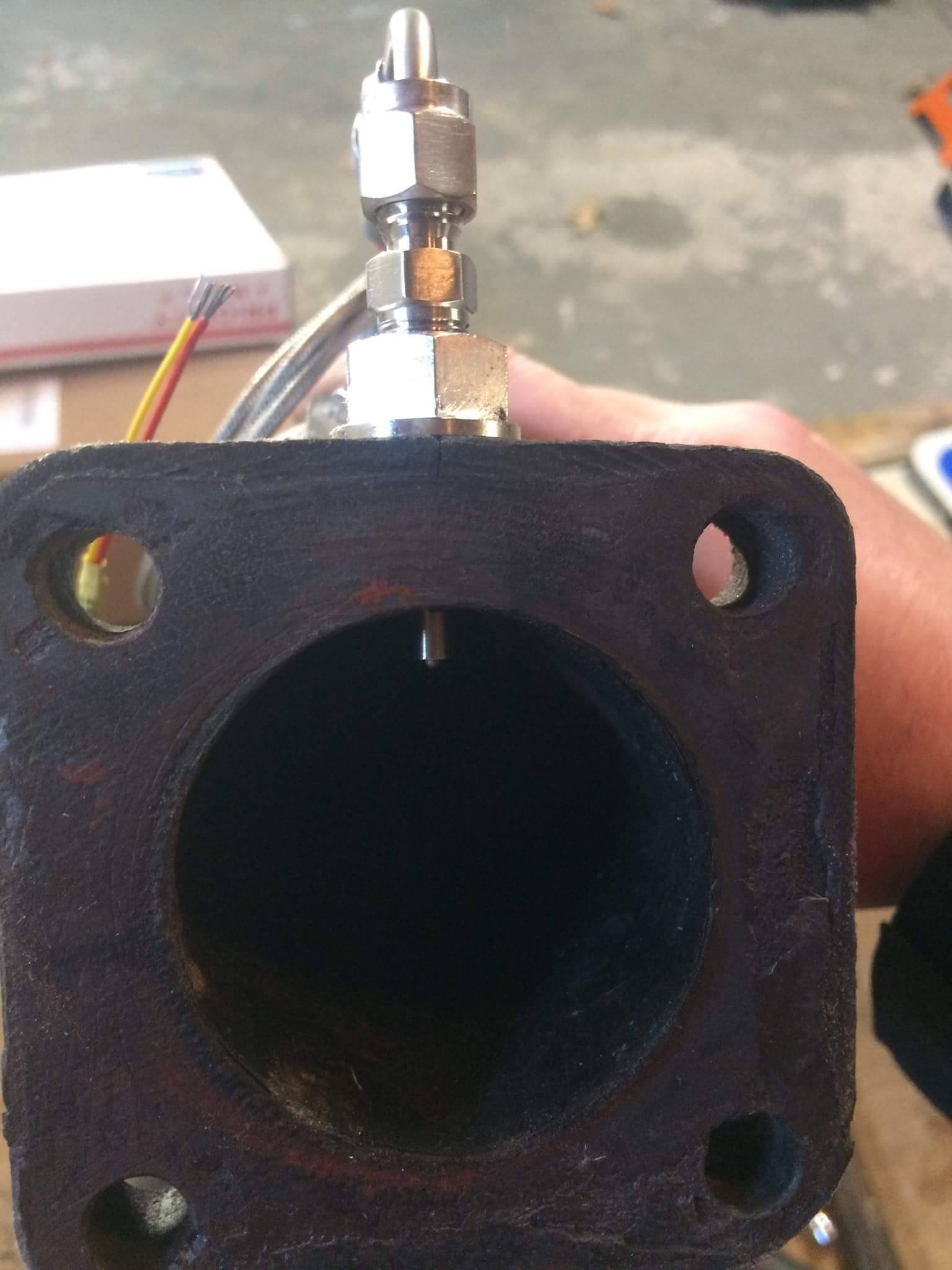

Relocated EGT probe post turbo for easier access... not too concerned about EGT accuracy... New probe is open tip style...

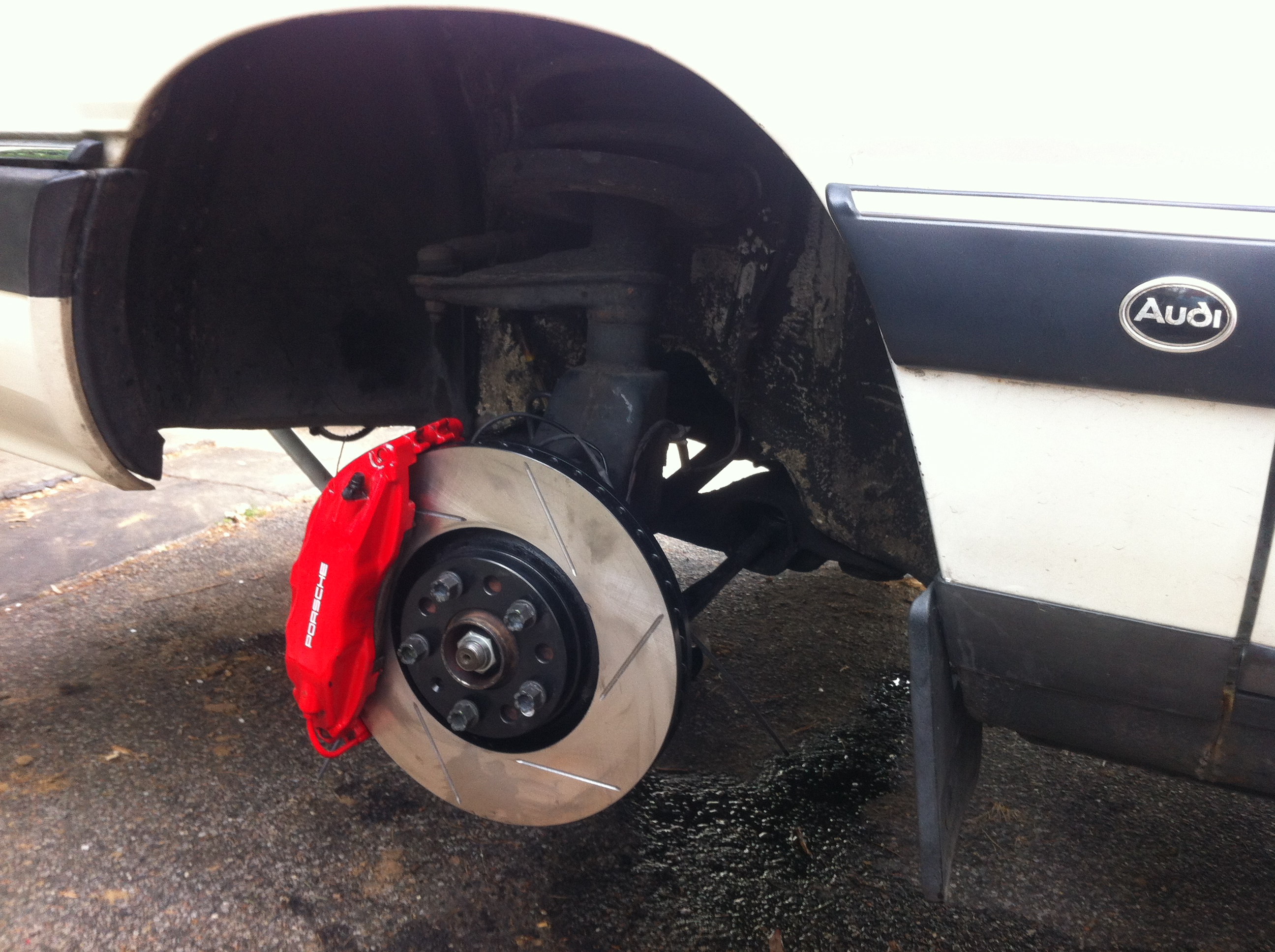

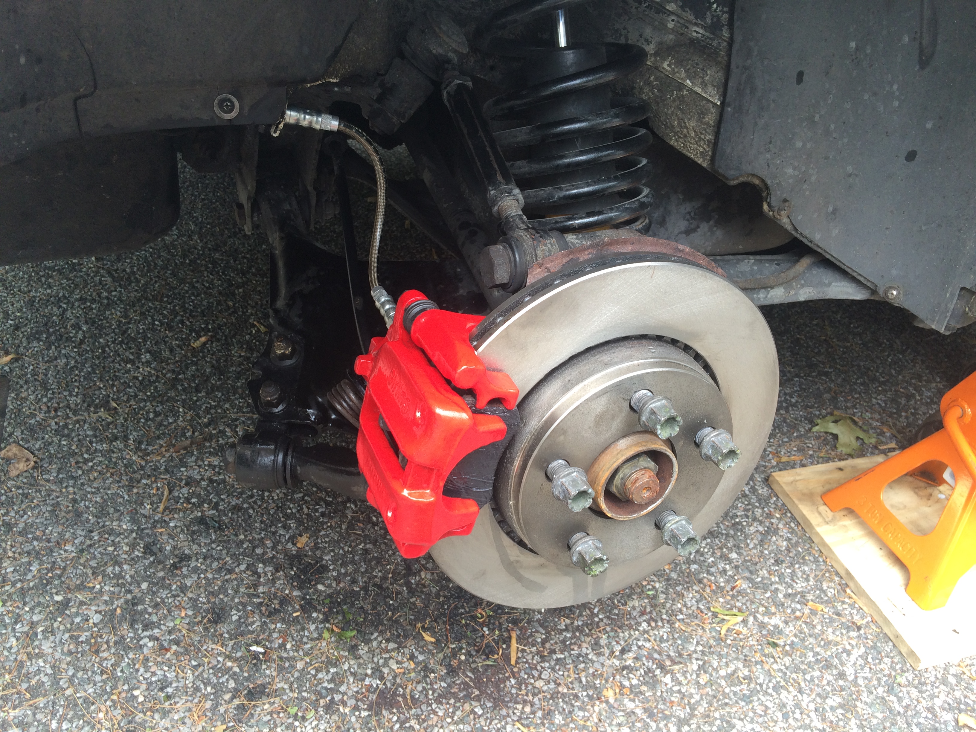

Front and rear brake upgrades...
Front: stock Girling G60 269mm > upgrade Brembo 993TT 321mm
Rear: stock 245x10mm solid > upgrade 220 20v 269x20mm vented...

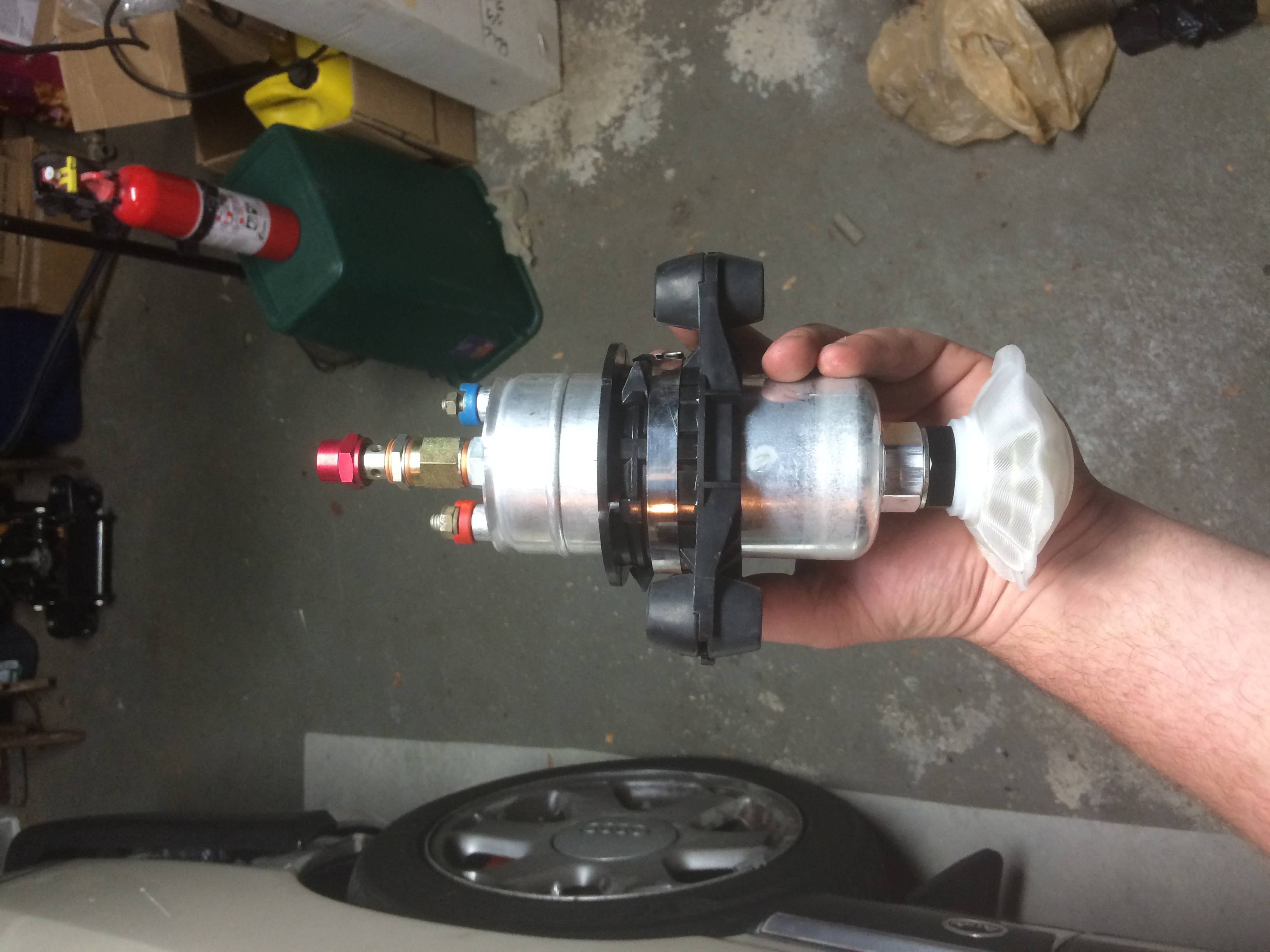

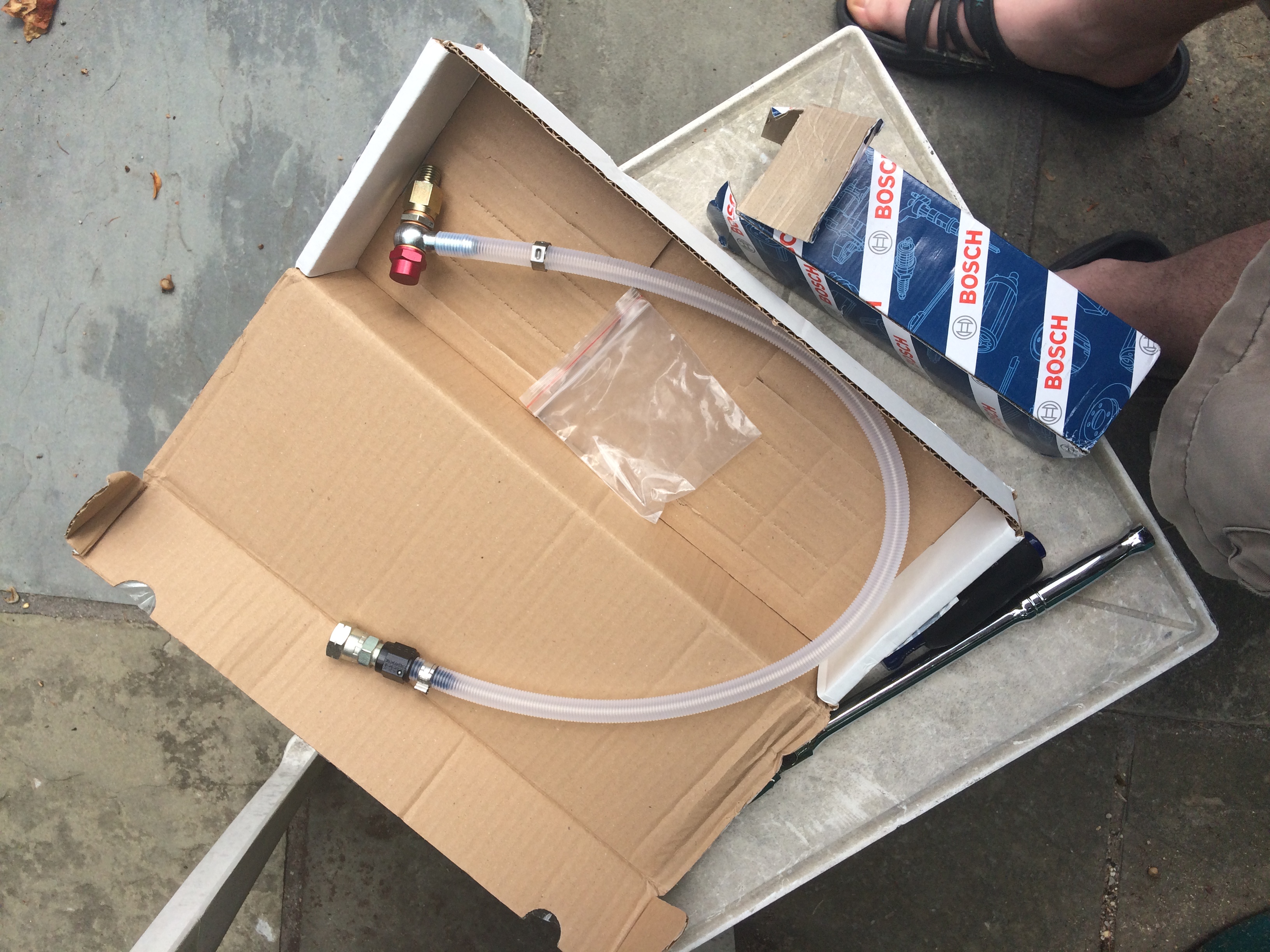

Fuel Pump upgrade: Bosch 044 pump, upgraded intake line, fuel pump relay upgrade...

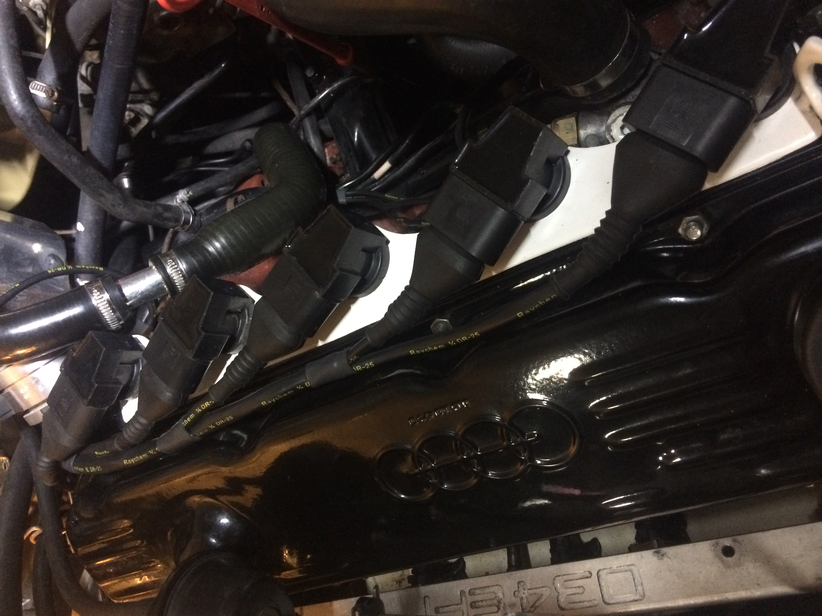

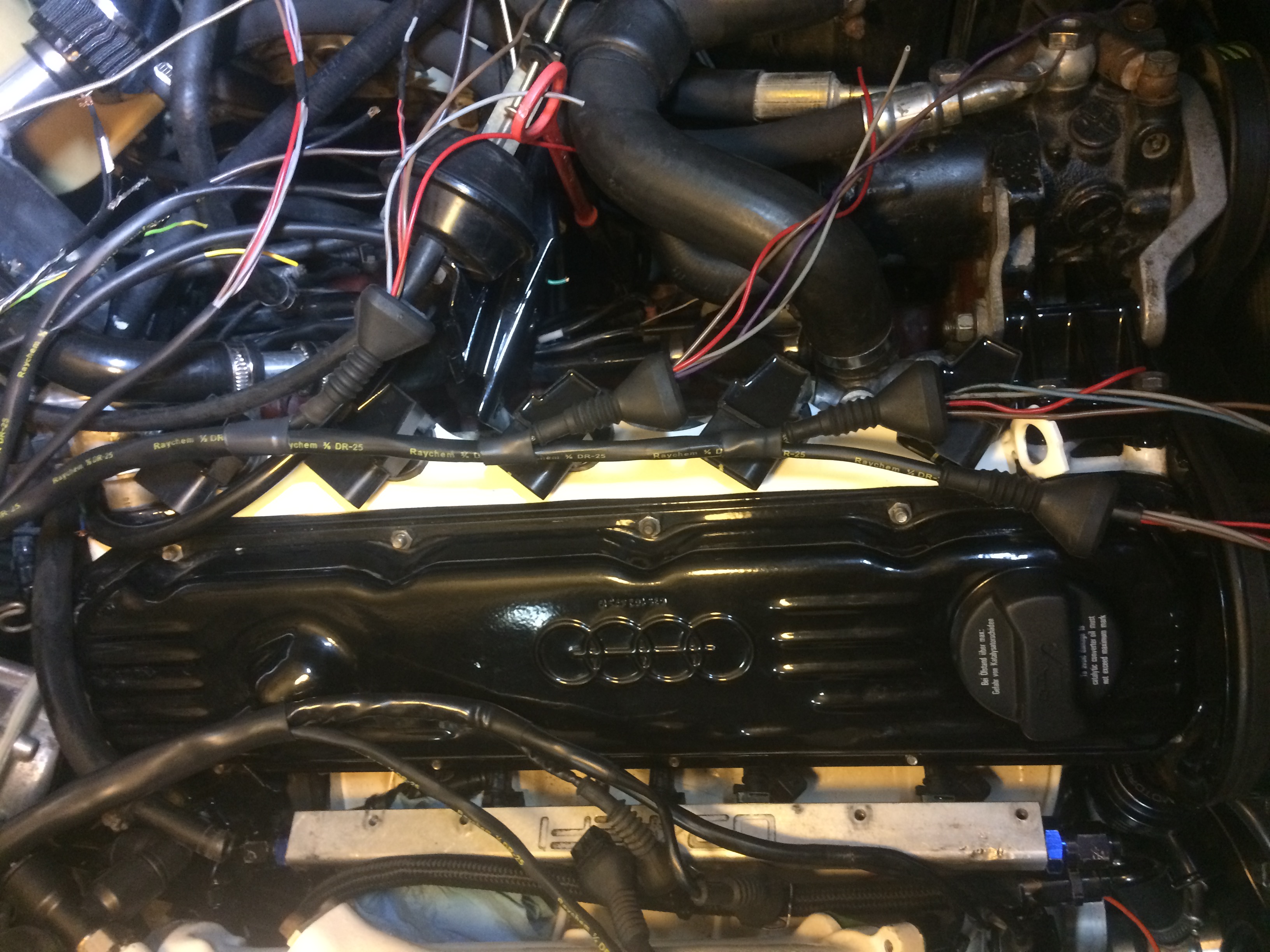

One off VW 1.4L coil mounting solution inspired by a European counterpart... This one was designed and fabricated by HPR...

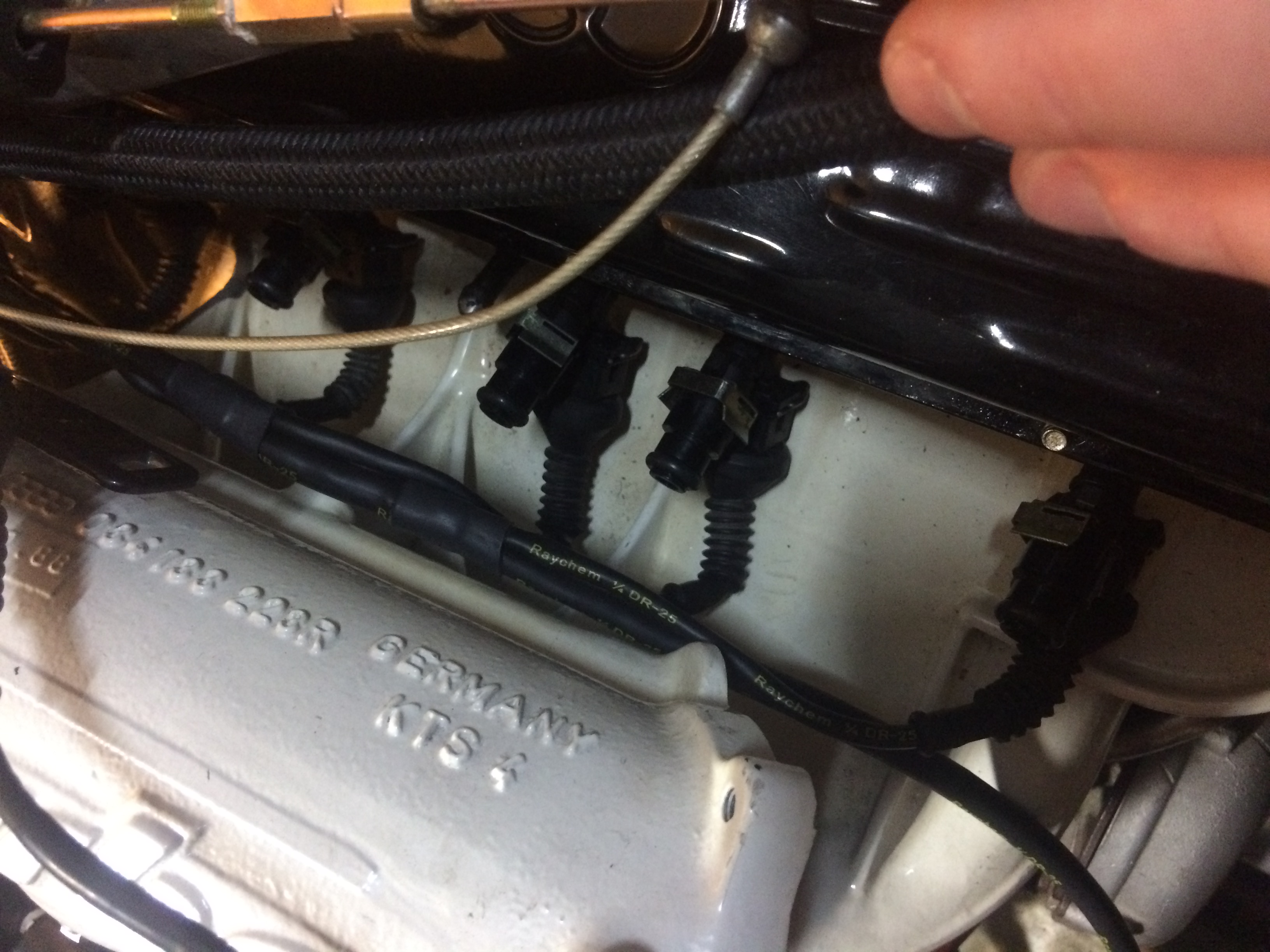

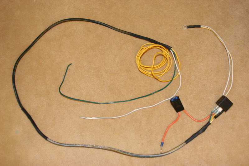

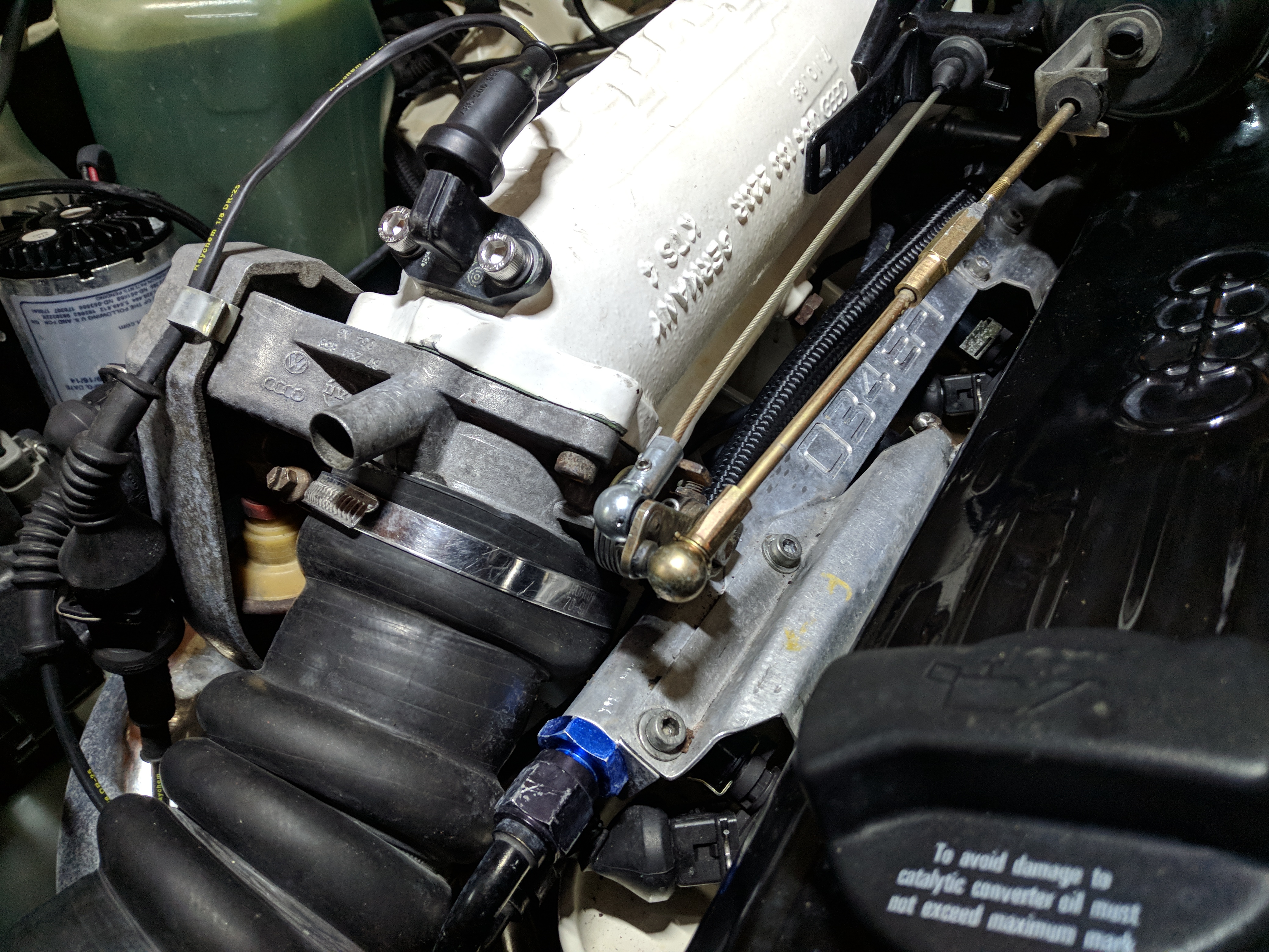

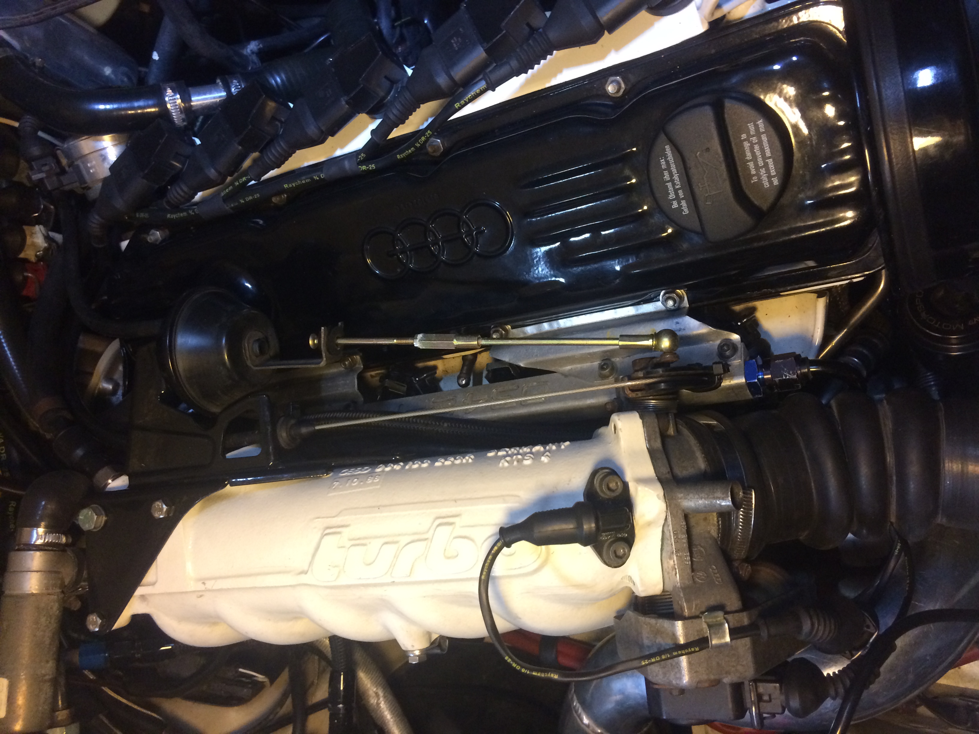

Reworked the wiring harness with DR-25 in the fall of 2017...
Late winter 2017 I fixed the throttle linkage interfere issue with the throttle cam lobe hitting the fuel rail... solution, 20vt fwd throttle cam and a cable end linkage from Australia
