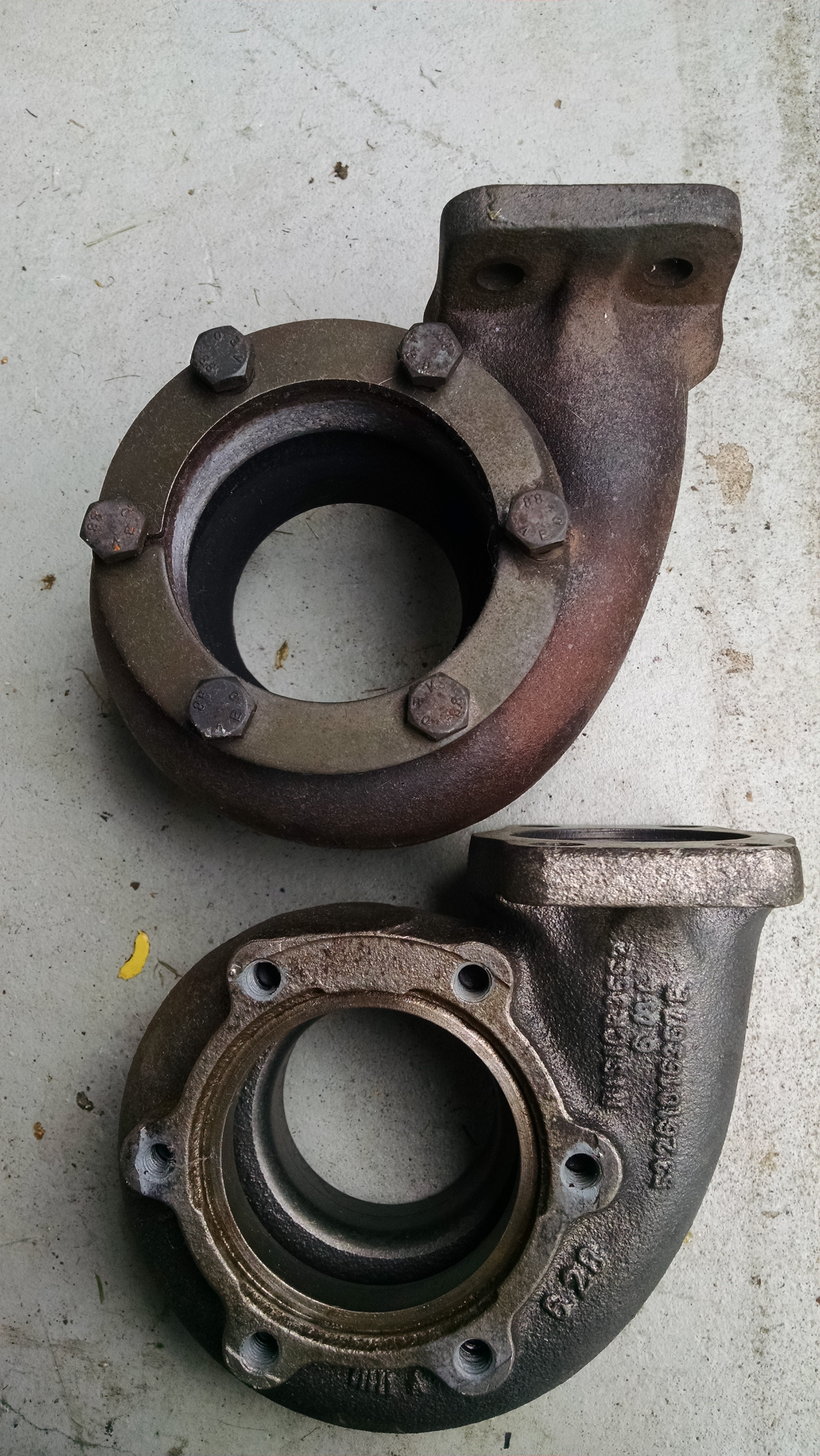

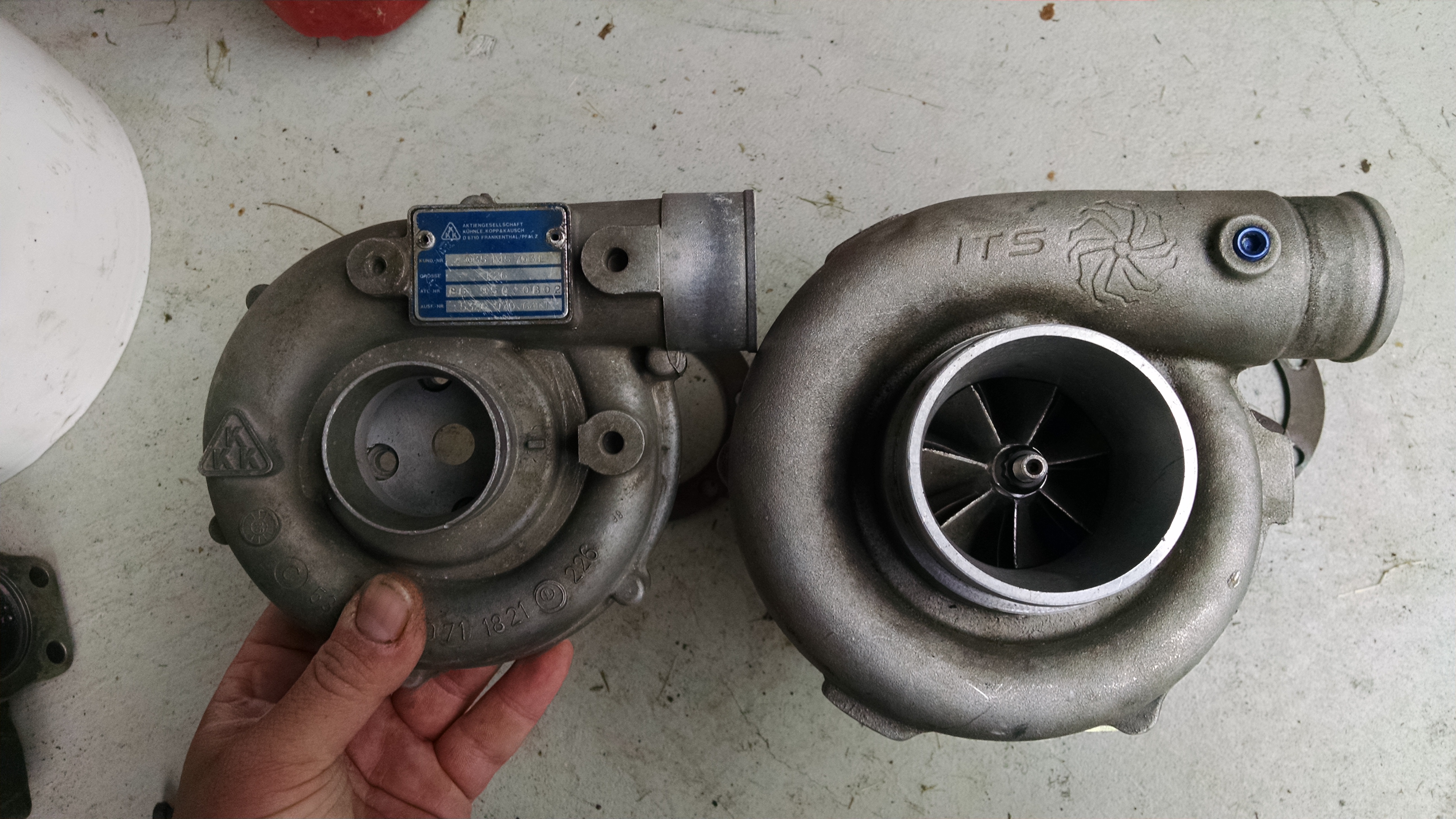

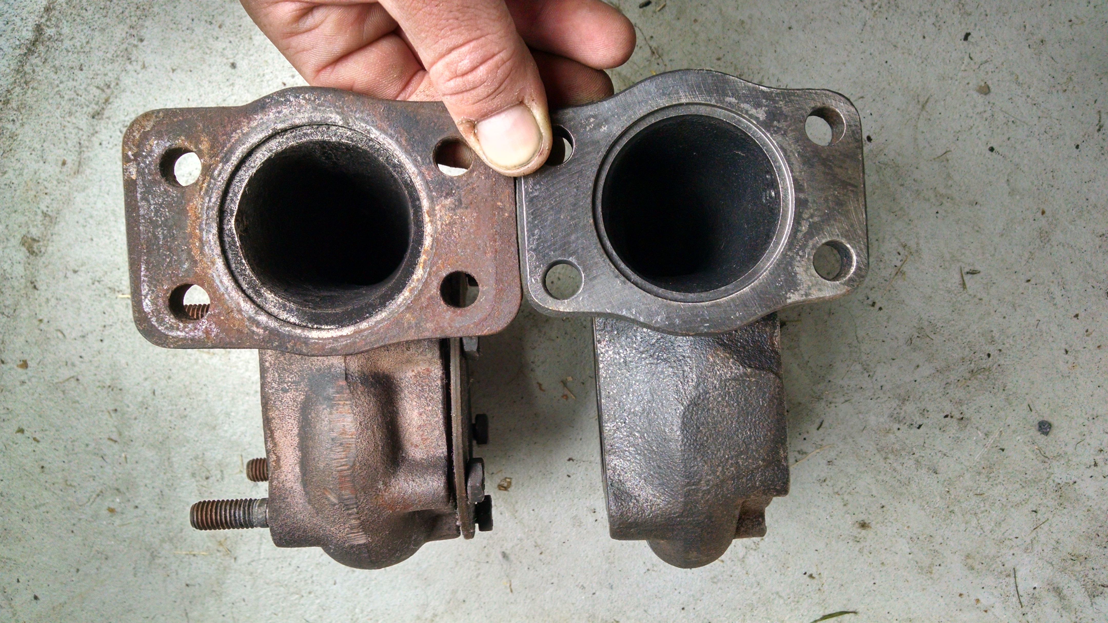

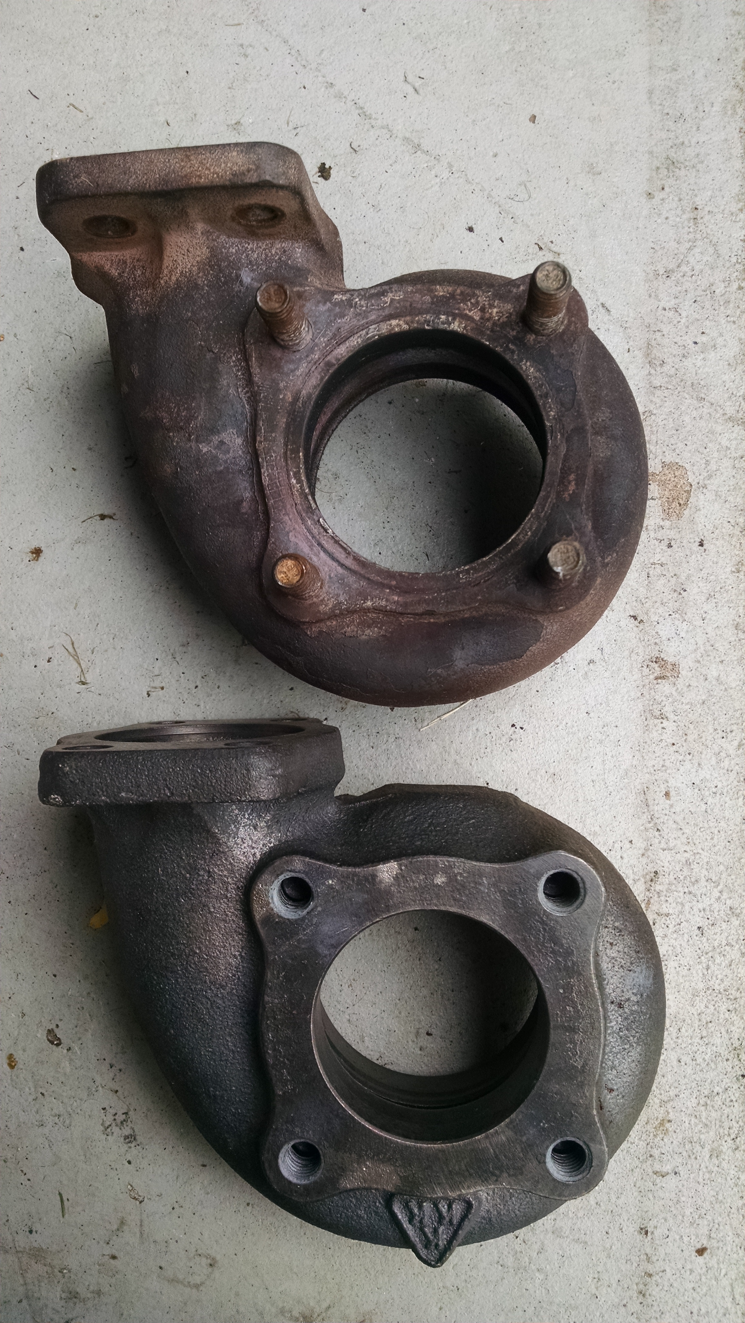

I posted this in my project tread, but figure I'd put it here too. Here are some comparison pics I took. The turbine housing is being compared to an Audi K26 housing. The compressor housing is being compared to a Porsche K26/6 housing. I don't know if there is a difference between the Audi and Porsche compressor housings, so I wanted to make sure toet you know which one it is.

Ohh anodized back plate
Re: Turbo guru's, I need some help!
Yep! Billet anodized back plate. From what I can find, ITS was a pretty high end turbo back in their day.88a5tq wrote:Ohh anodized back plate
