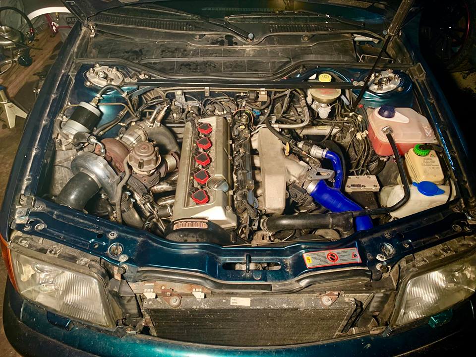

Thank you! I'm from Upper Michigan, I'm planning on having Marc tune it via Motronic. As far as the swap goes, its just about done. All that's left is some heat wrap, wire in the wideband, finish up the wastegate dump, install the injectors, and do the ECU work. When that's all done I can finally clean the bay for good. Its surprising how dirty things get just from working on it. Oh, I also need to figure out what to do with the Valve Cover Breather hose and the bypass valve (I'm assuming just replace it with a BOV).ringbearer wrote:Welcome! What are your plans for tuning and where are you?
Thank you sir, I checked the flanges for flatness and they seemed fine. I normally file the flanges of cheaper manifolds before I use them anyway. I will be building a brace for the turbo soon here also. On my Supra and DSM I welded steel rod from flange to flange to stiffen it up. No failures so far!morris400 wrote:Great start man. One thing, if that's an Ebay manifold I'd recommend having a shop check the welds and plane the flanges. I had one (never used it) and that's what my plans were. Over all it's ok quality and should be just fine. Build a brace for the turbo the take the weight off the manifold as well.

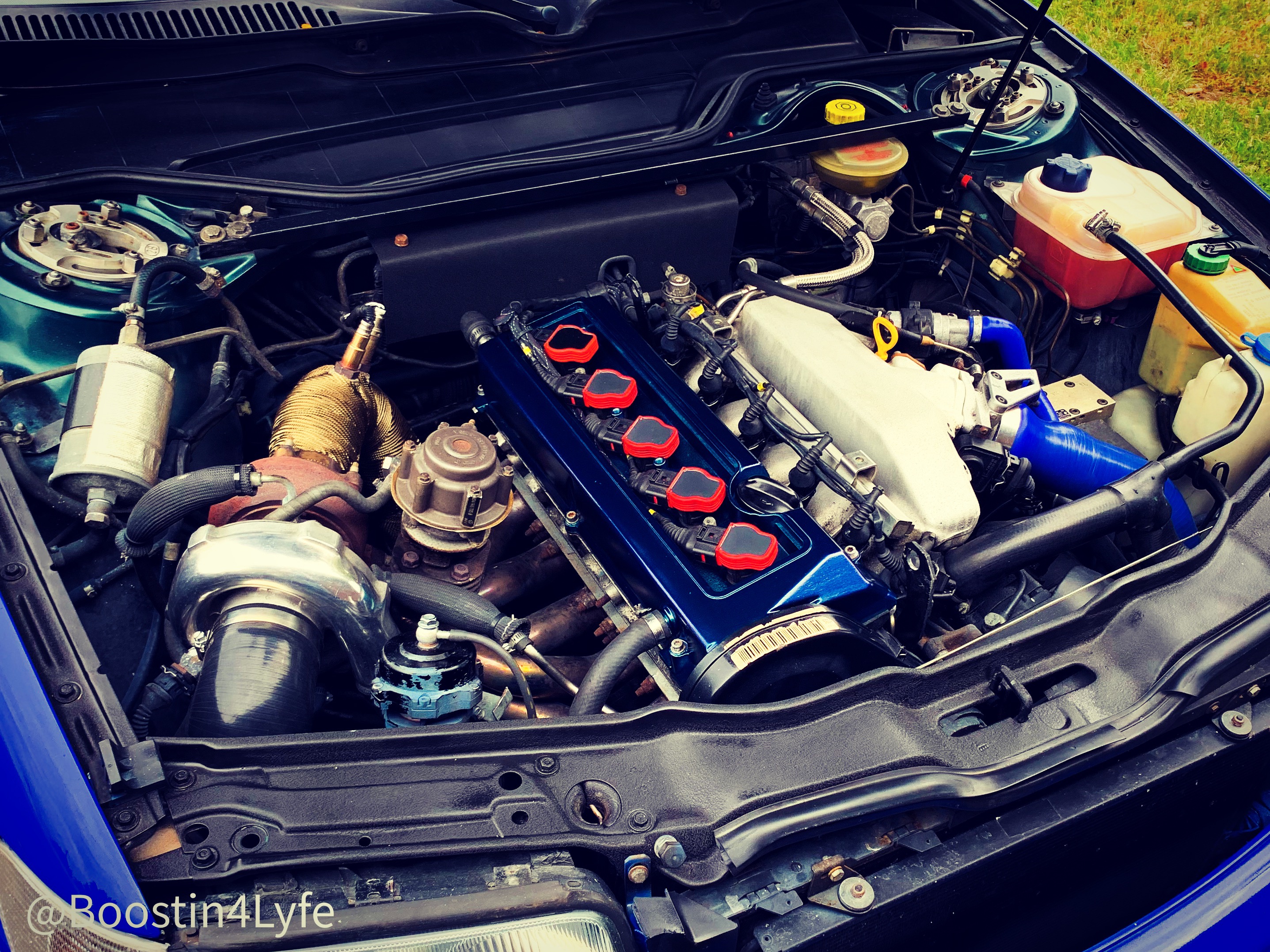

Long needed update on the car, its pretty much done. Oh and its Nogaro Blue now!
