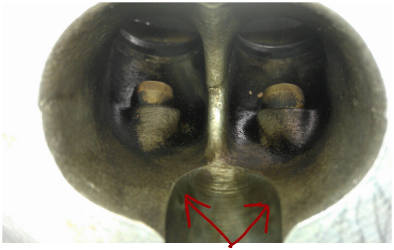

Looking at the port from the viewpoint of air going into it, it appears to be a little counter intuitive to see less of the valve in the modified port than the stock item, however looking at a sectioned head shows a different story.
In short i believe the ssr shape is already wrong as cast and needs material adding not removing in order to make it flow better.

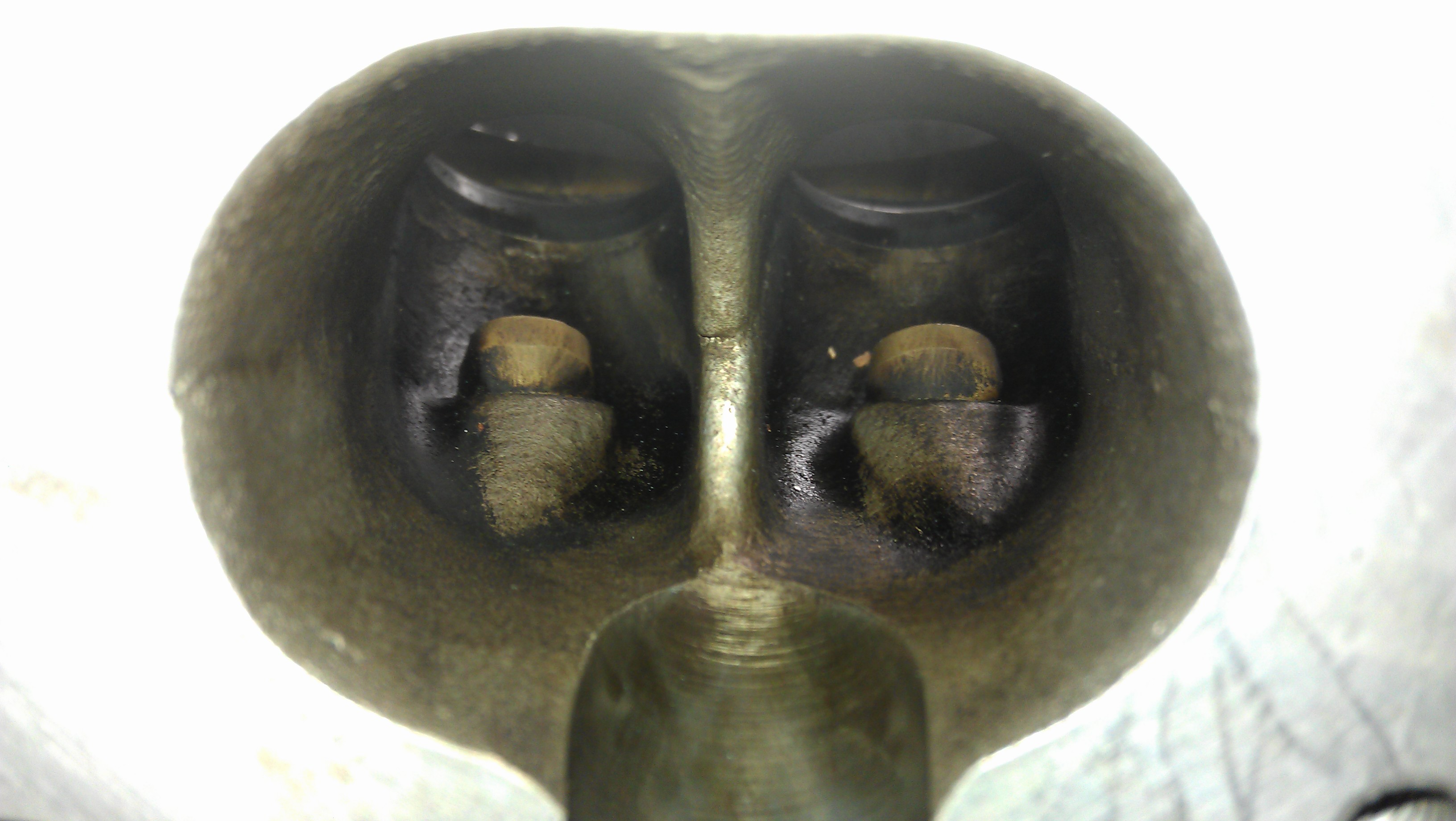

The photo shows the stock shape of the port floor vs what works better, the reason for the turbulence (and its tell tale noise) becoming apparent.
It appears to me that airflow is staying attached to the ssr for longer and also causing air to be pushed higher towards the longside so utilizing more of the available valve area.

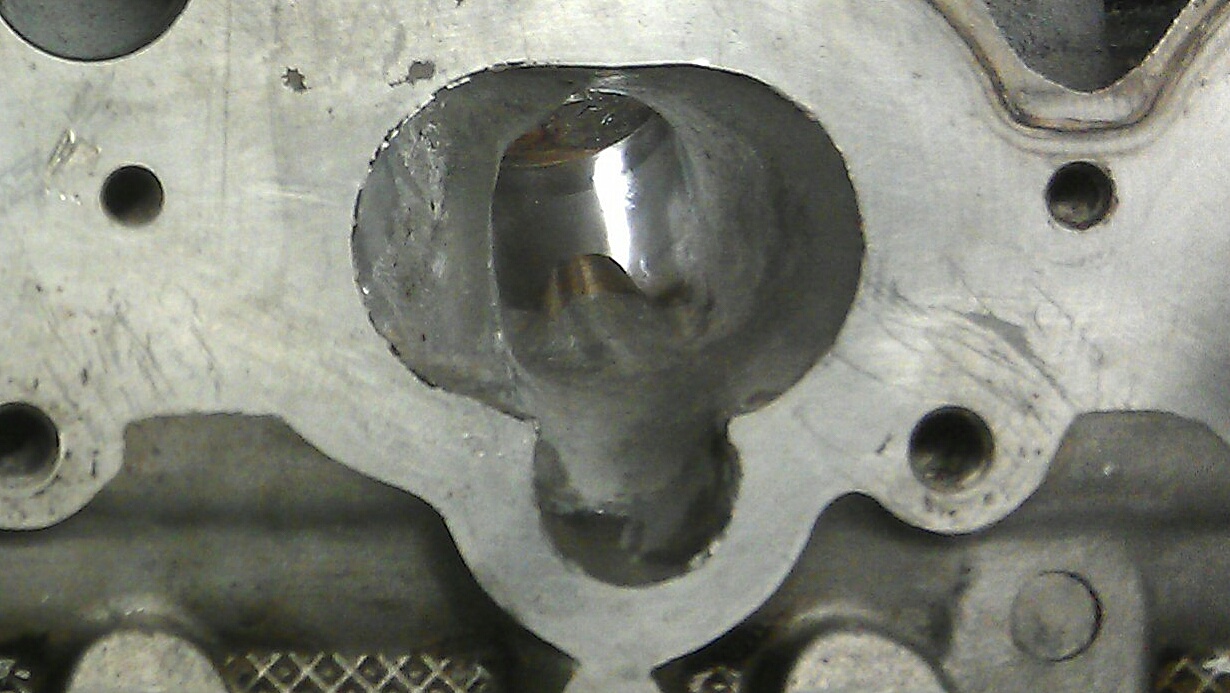

This is the same port just painted to better show how the profile would look without the distraction of the parent material and some measurements of material thicknesses.
As you can see, i contend the airflow separates just prior to entering the valve throat (red arrow), effectively shooting across the back of the valve rather than staying attached to the ssr due to its shape not being conducive to keeping the flow attached.
That creates turbulence which in turn chokes off flow and makes the port noisy.
Lengthening the ssr by raising it and the port floor allows the airflow to stay attached to the curve and as a result flow goes up and turbulence goes down.

My question is if you blend the edges on the channel for the injector will that change things for better or worse?
like this mostly finished example:
From this:
my thoughts for this is to keep atomized fuel from hitting the wall and puddling or sheeting down the ports. i would appreciate your thoughts or collecting some data on this.
Hiya, if i interpret you correctly youre talking about the actual splitter/centre divider of the port?
If thats the case so far ive not found any difference in flow when going from that bluff shape to a knife edged divider.
Thats not to state that it makes no difference, as at this point i cant say, its not something ive tested for.
Its entirely feasible it may make a difference when the velocity in the ports goes up in which case its not something i can really test for.
What i can do however, is run a few lift tests on the next head i do ( next week) and compare the befores and afters of only modifying the splitter itself.
I feel at this point it might make a difference due to the cross sectional area of the port getting larger at the point the splitter starts, but its also possible itll improve flow by not being so large and obtrusive or squeezing the airflow as it goes over it.
Its something ill have to report back on shortly, hope that helps some.

no, sorry, i ment removing this material to help unshroud the injector:
4v6
Posts: 36
Joined: Mon Apr 29, 2013 4:09 pm
Re: 20vt AAN/ABY/3B/7A heads, some data.
Post by 4v6 »
I see what you mean now scubadave.
I found that most of the air was travelling (in your photo) towards the top left and top right of the ports, hugging the short side radius, and in the middle of the port and not much was happening elsewhere.
That far out on the injector area i never found any difference by putting restrictions in as most of the airs just not moving there.
I dont think itll make any difference to open it out there due to the above but i also dont think itd cause any harm if youre intent on doing it.
