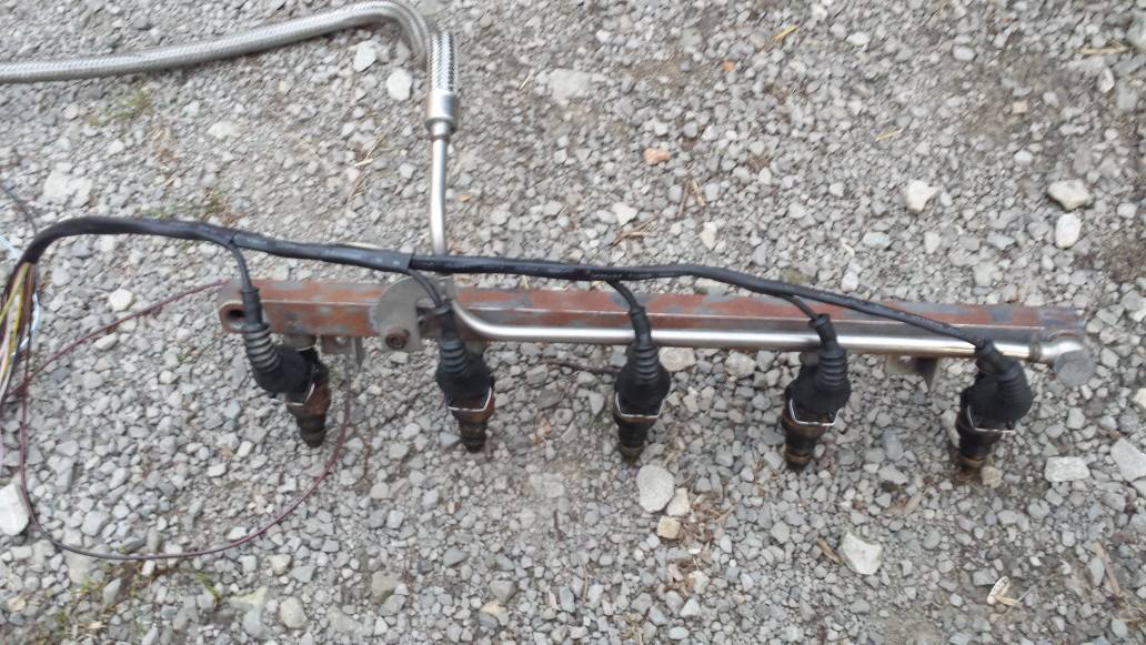

Aaaaaand wiring progress. All I have left is ECU side and the crank sensor.

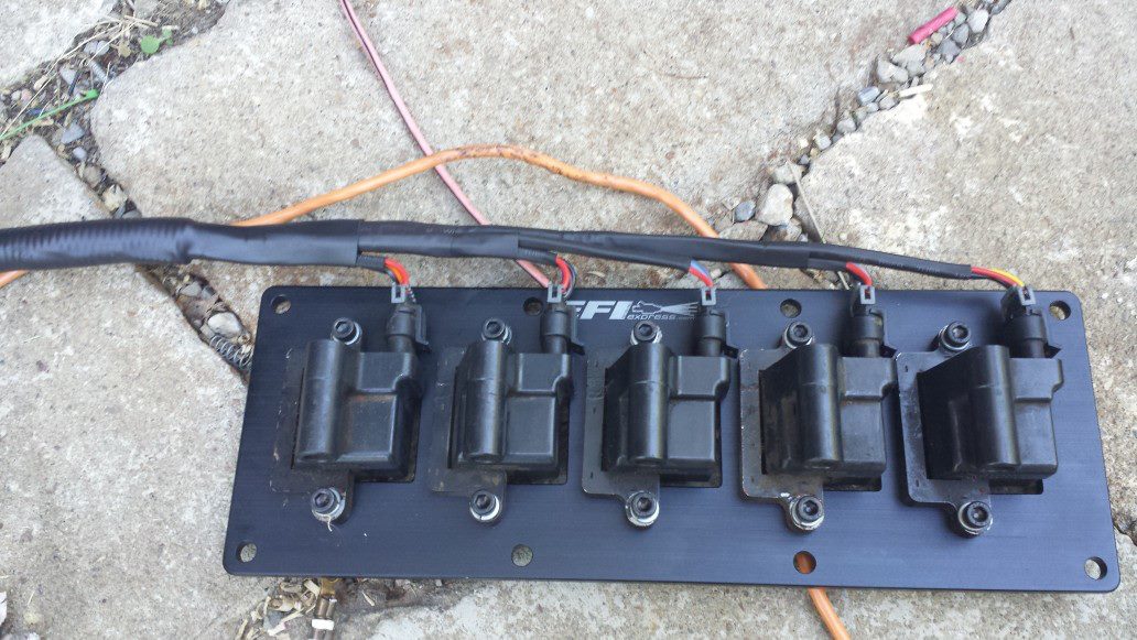

That would be cool. I eliminated a lot of stuff, and I'm running LS coils too. But at least part of it should be the same.

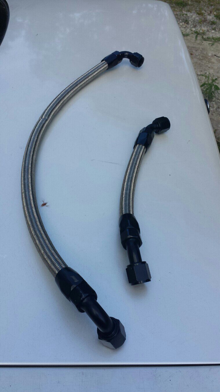

Baby's first braided lines. Oil cooler lines, specifically.
Sent from my SCH-I545 using Tapatalk 4
Re: Gtn116's 5k 20vt
Dem purdy
