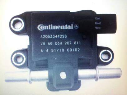

Vw part.
It is much cheaper and works good and it is the same as Zeitronix
