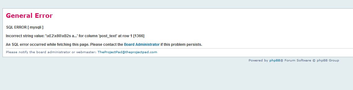

Got this:

Odd. Can you paste the text of the post here? Did it contain any special characters/etc?

EDIGREG wrote:Odd. Can you paste the text of the post here? Did it contain any special characters/etc?
Same error. What I'm trying to do is quote a post from the even organizer. I click the quote buttons in the full editor and paste in his message.

So that works, odd. See my attempts in the gatherings section? It showed up as guest. Very odd.

Ok, so I figured it out when saving it in notepad. Said something about unicode text.

EDIGREG wrote:Yes, will do...but only if you email me the exact text including any Unicode characters!
Sent. The only way I could send it was directly pasted into your email. Putting it into a notepad text stripped the unicode.

I think I know whats going on here.
We had to migrate the forum from microsoft SQL to MySQL and in the process the table definition isn't 100%. I think I can fix this by doing a table backup, recreating the tables from scratch and importing the data back in.
I see the same error in my import script, which is why some guys that requested project threads only got half of it imported or whatever. I'm looking into it.
