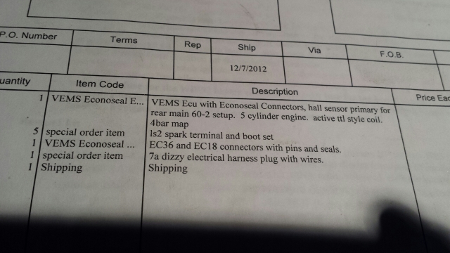

vwnut8392 wrote:actually the guy im getting it from said that he bought it from you marc, he said he was going to get in contact with you about a build sheet or something. i did ask him that and several other questions about the ECU hardware but all he knew was it was a V3 ECU. he was including the 60-2 crank seal sensor with it as he said it runs on that sensor ad the cam sensor i guess.
thats a hall type sensor, so I'll assume its setup for hall/hall. get me the serial number and I can look it up.

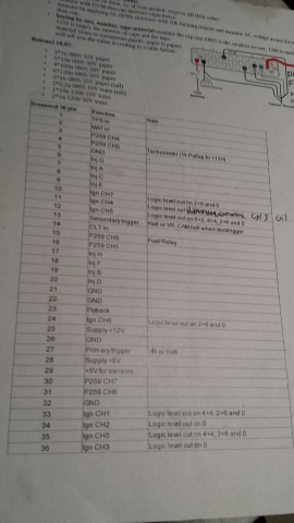

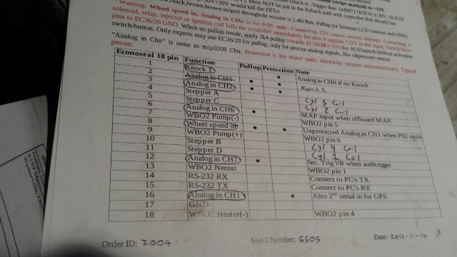

I didn't get the serial number yet but he sent me these pictures.

actually the serial number is in the second picture at the bottom, i just realized it. its 6505.
