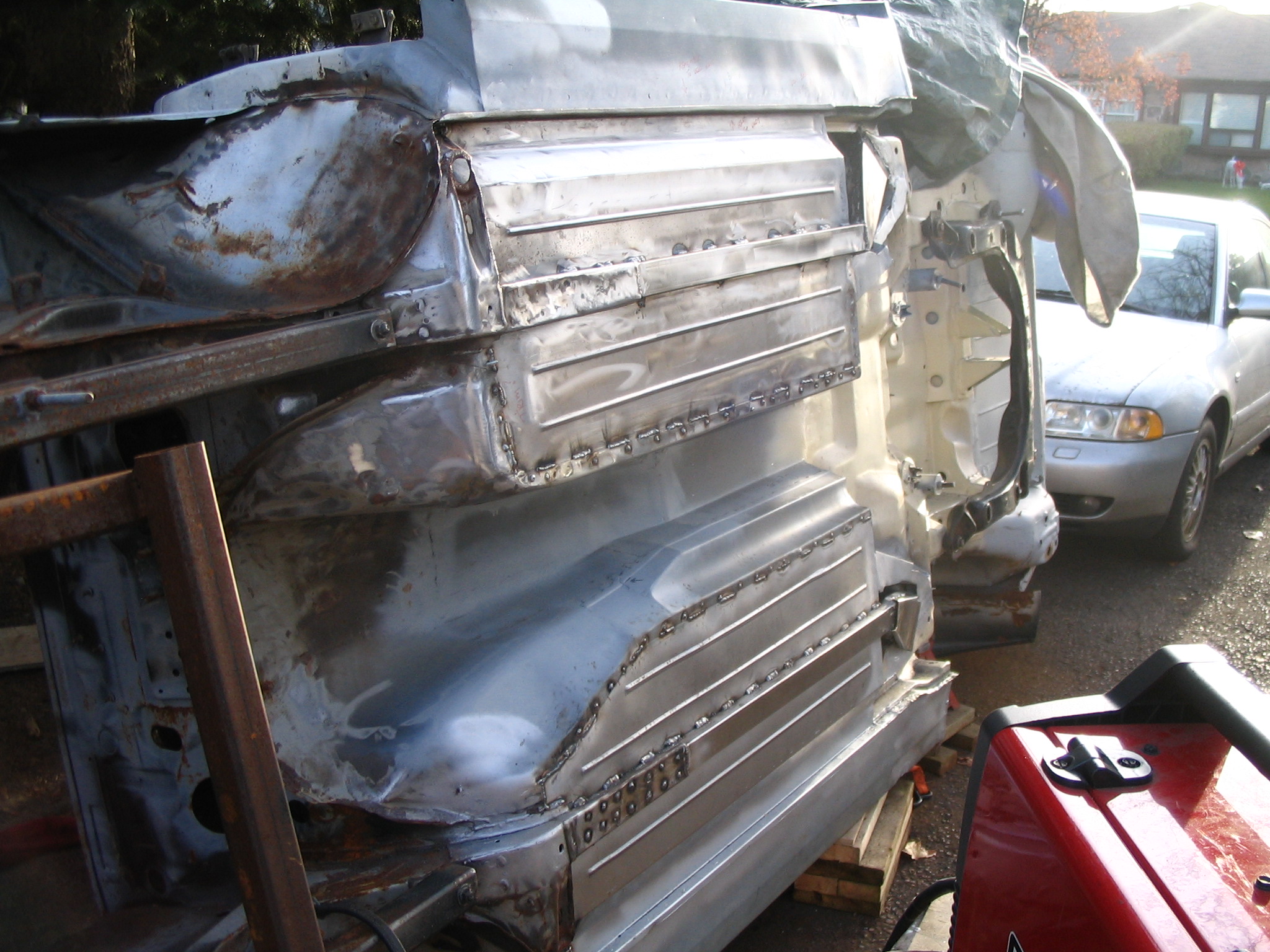

That is a lot of bends (work) looks sexy!
Re: Craig's Sport quattro build
Looks like you and I are having some very similar fun with rust and welding

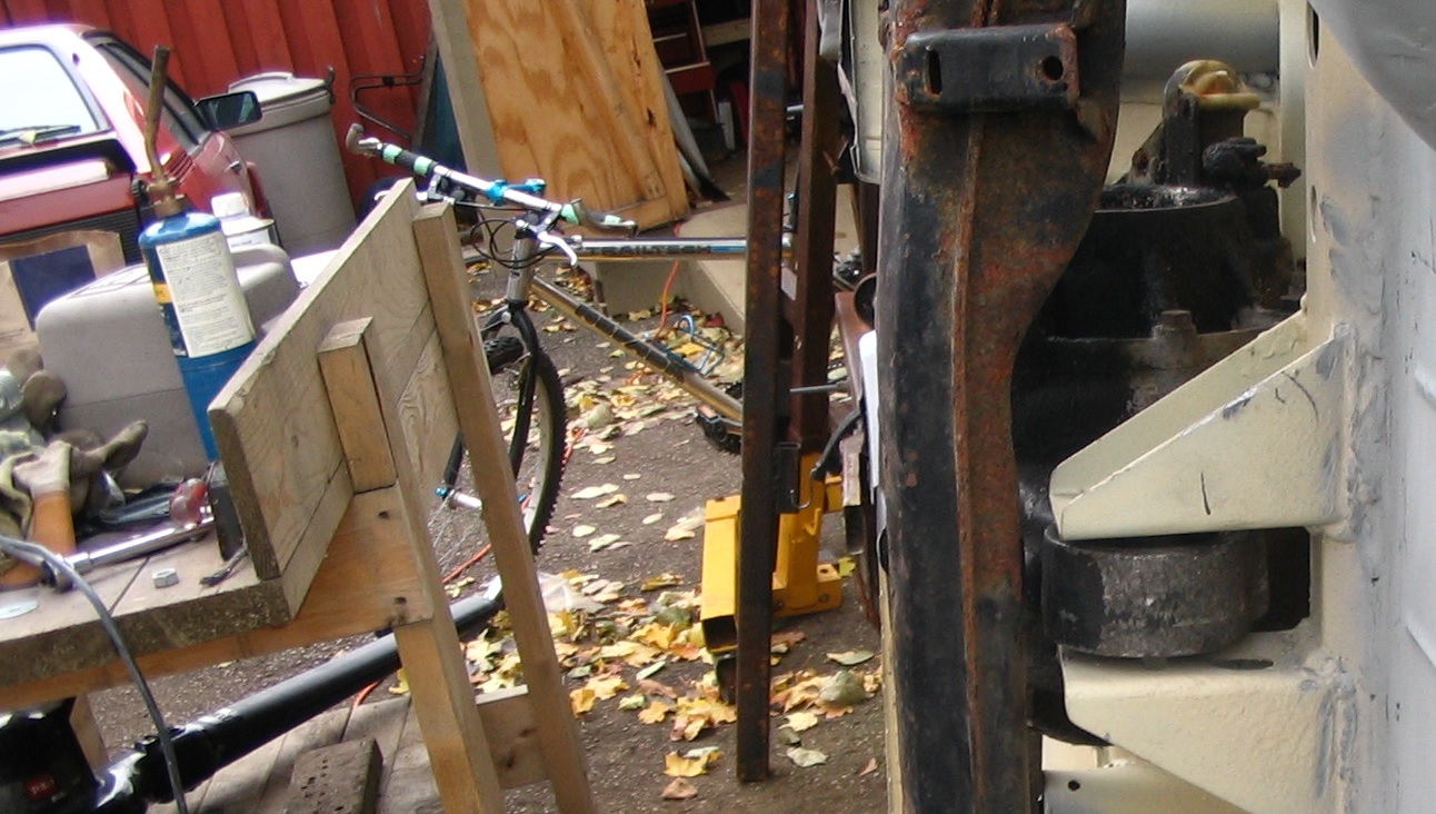

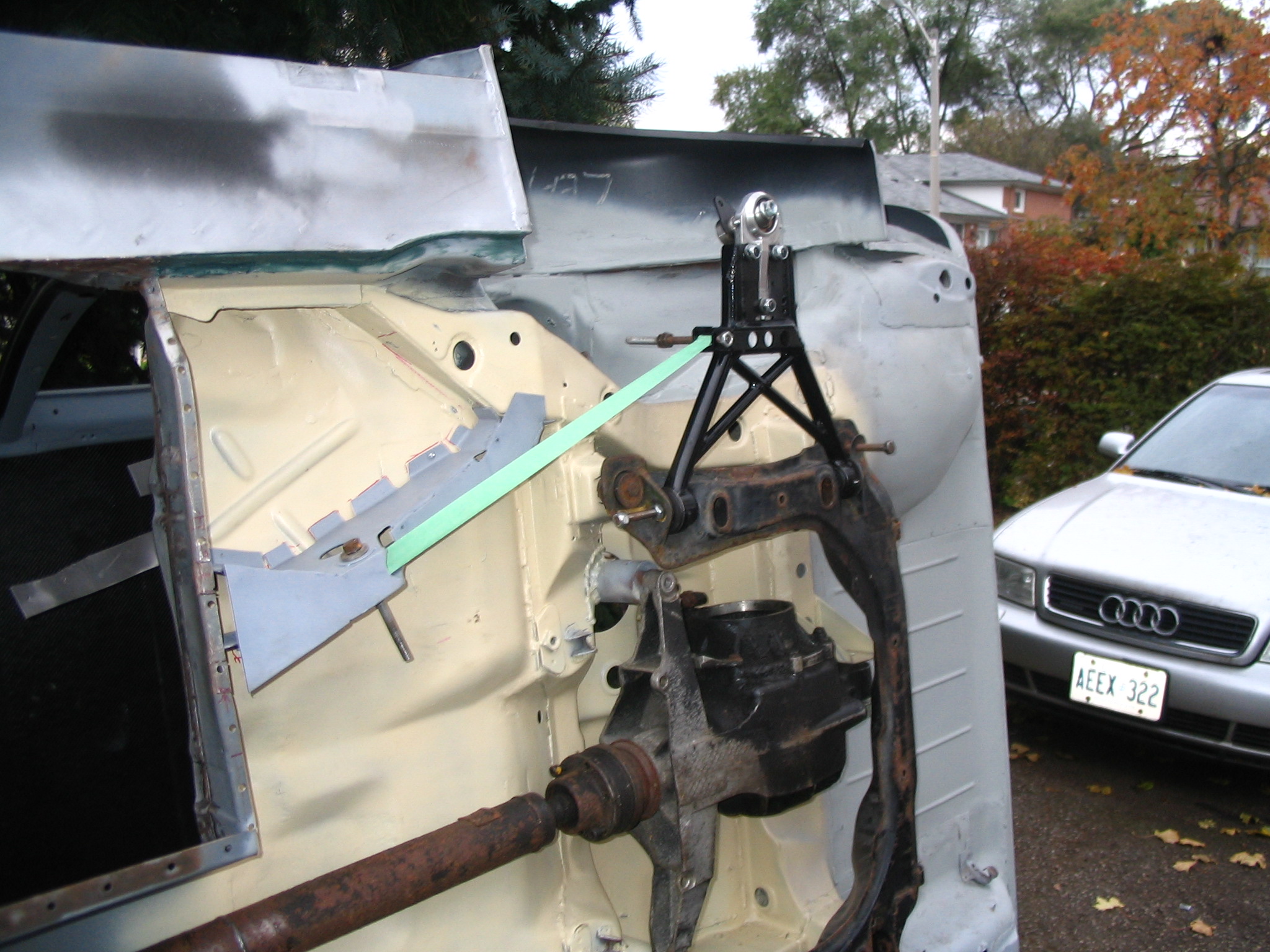

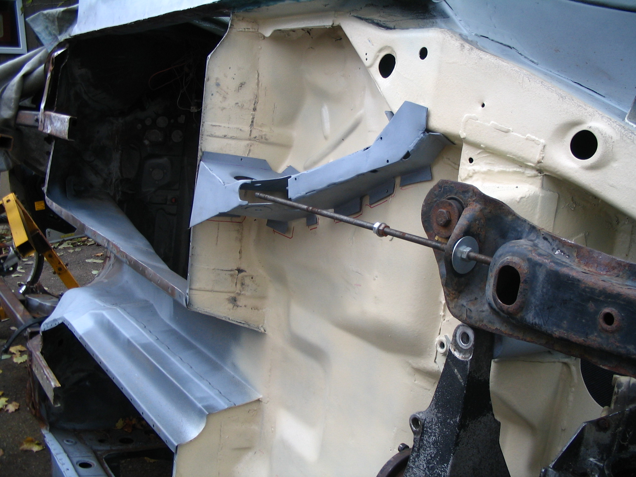

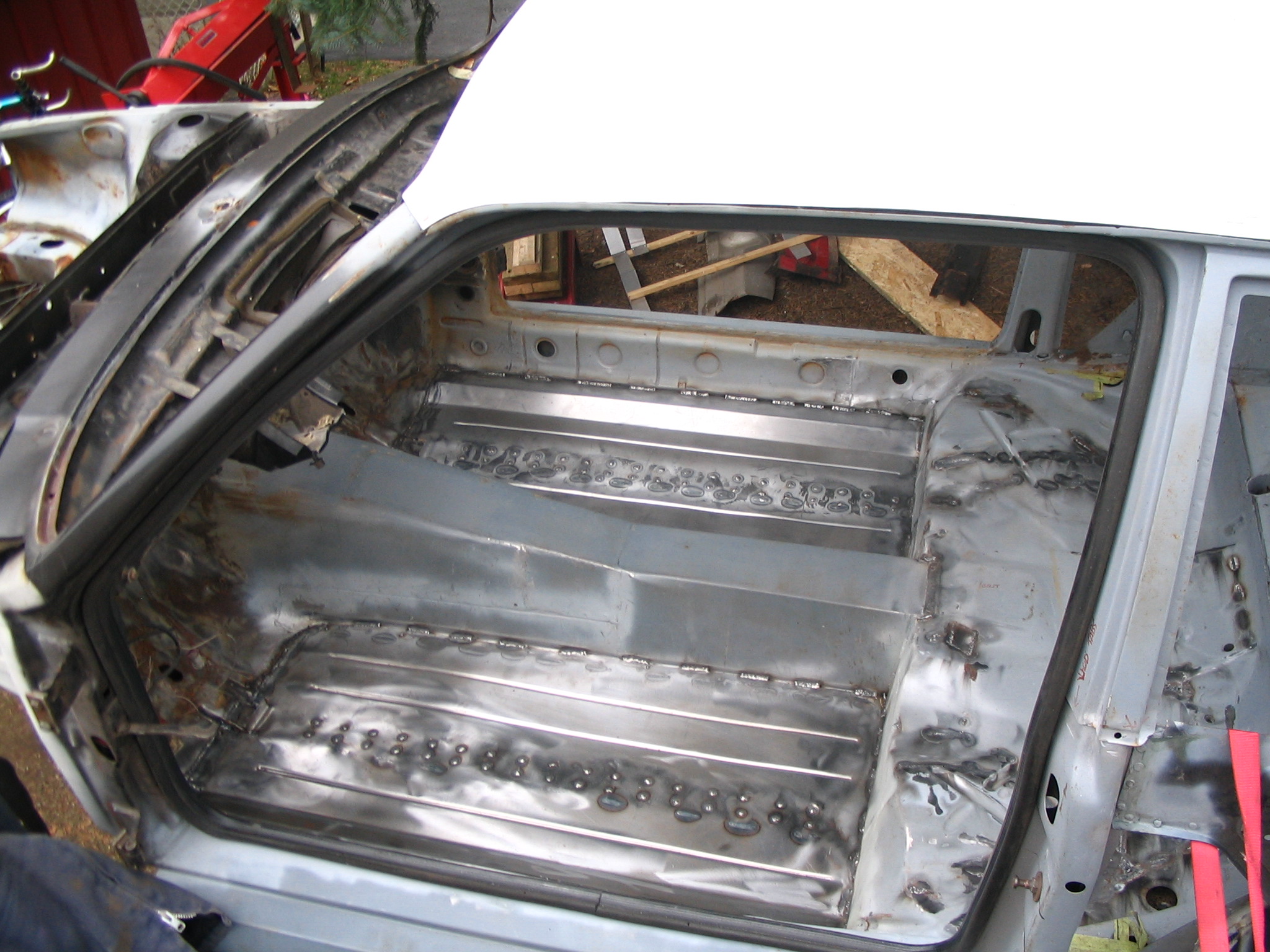

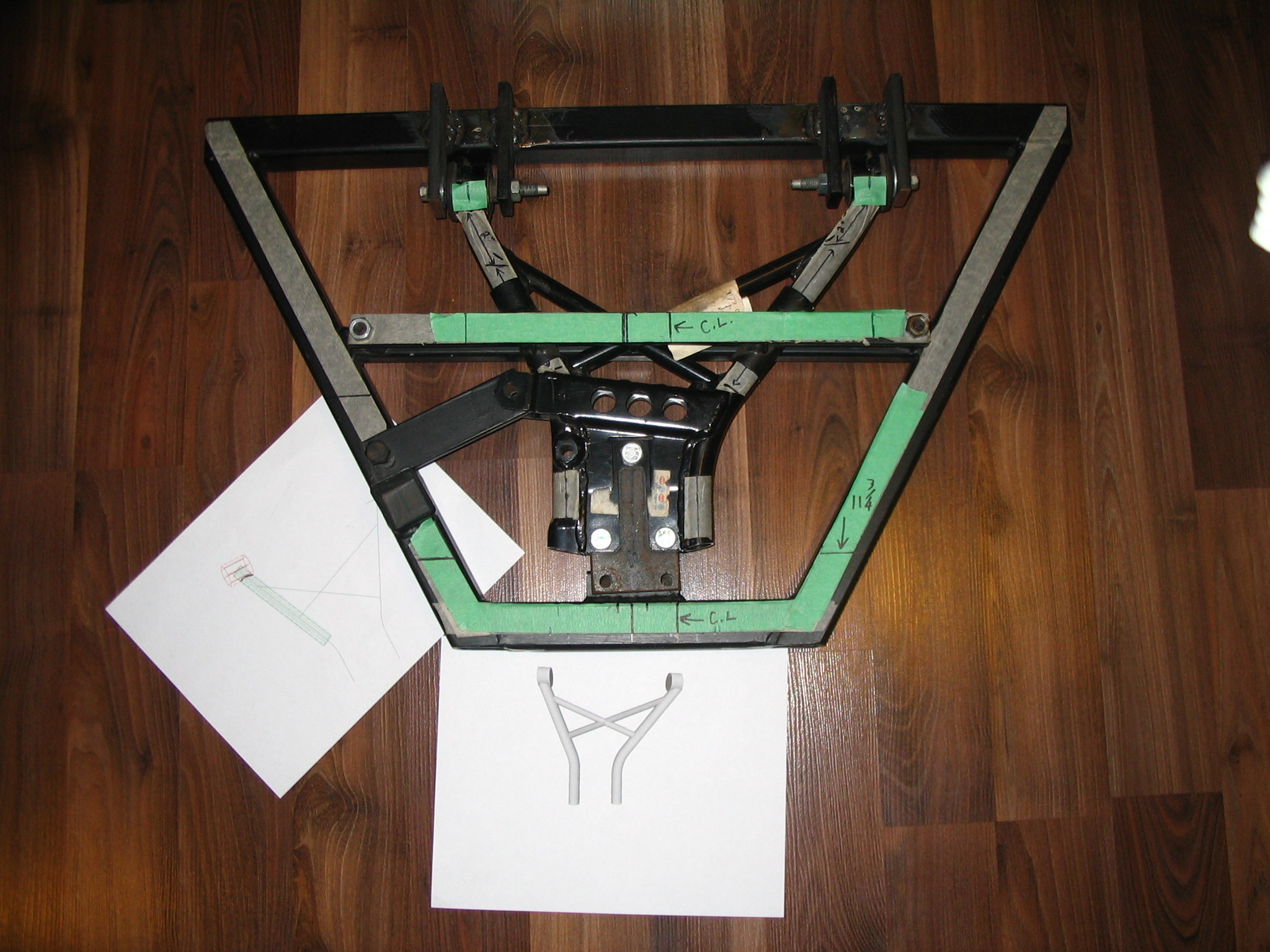

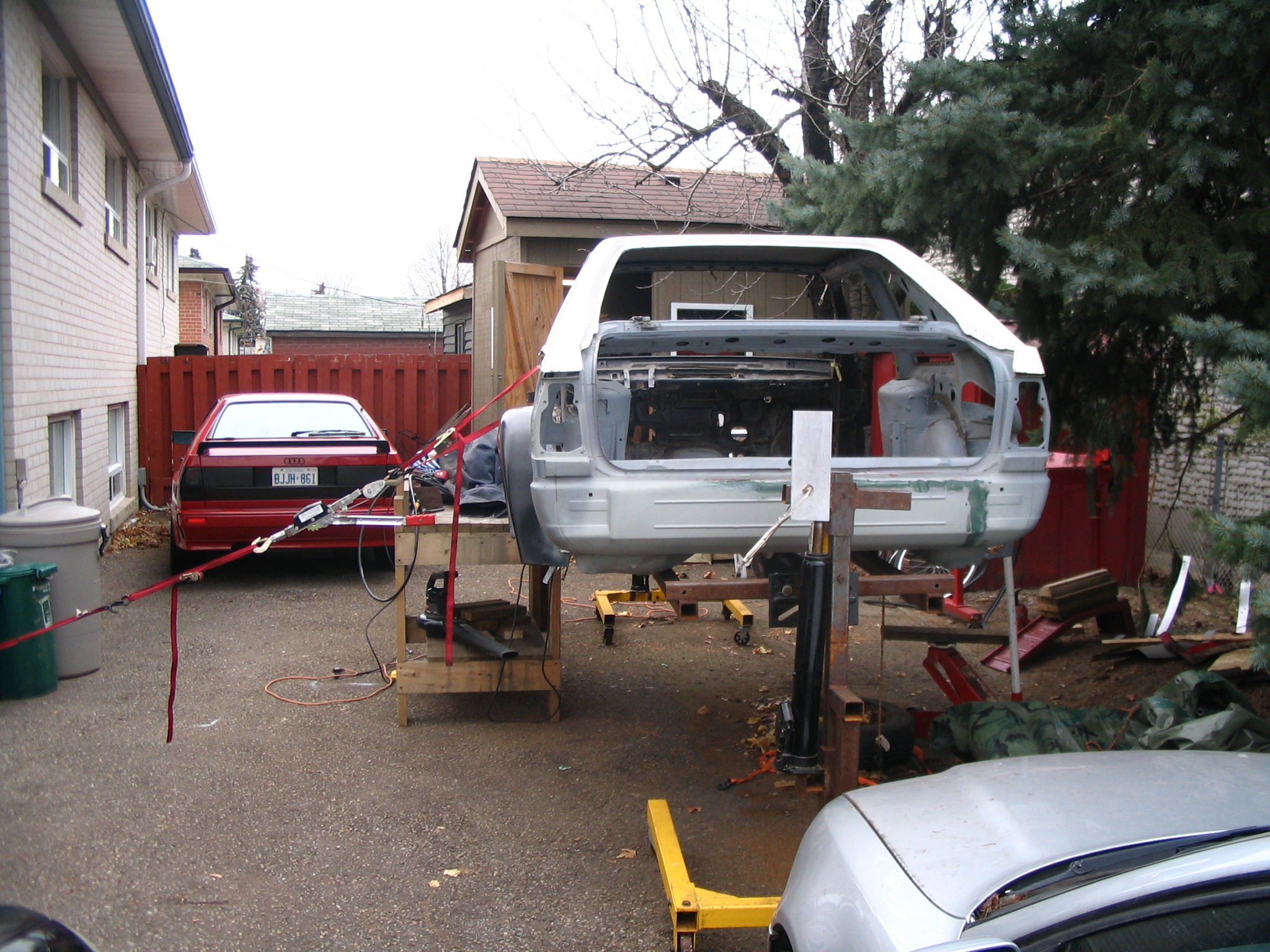

I had a very productive day.
The floor is nearly finished. I anticipate maybe another 15 hours.......hopefully

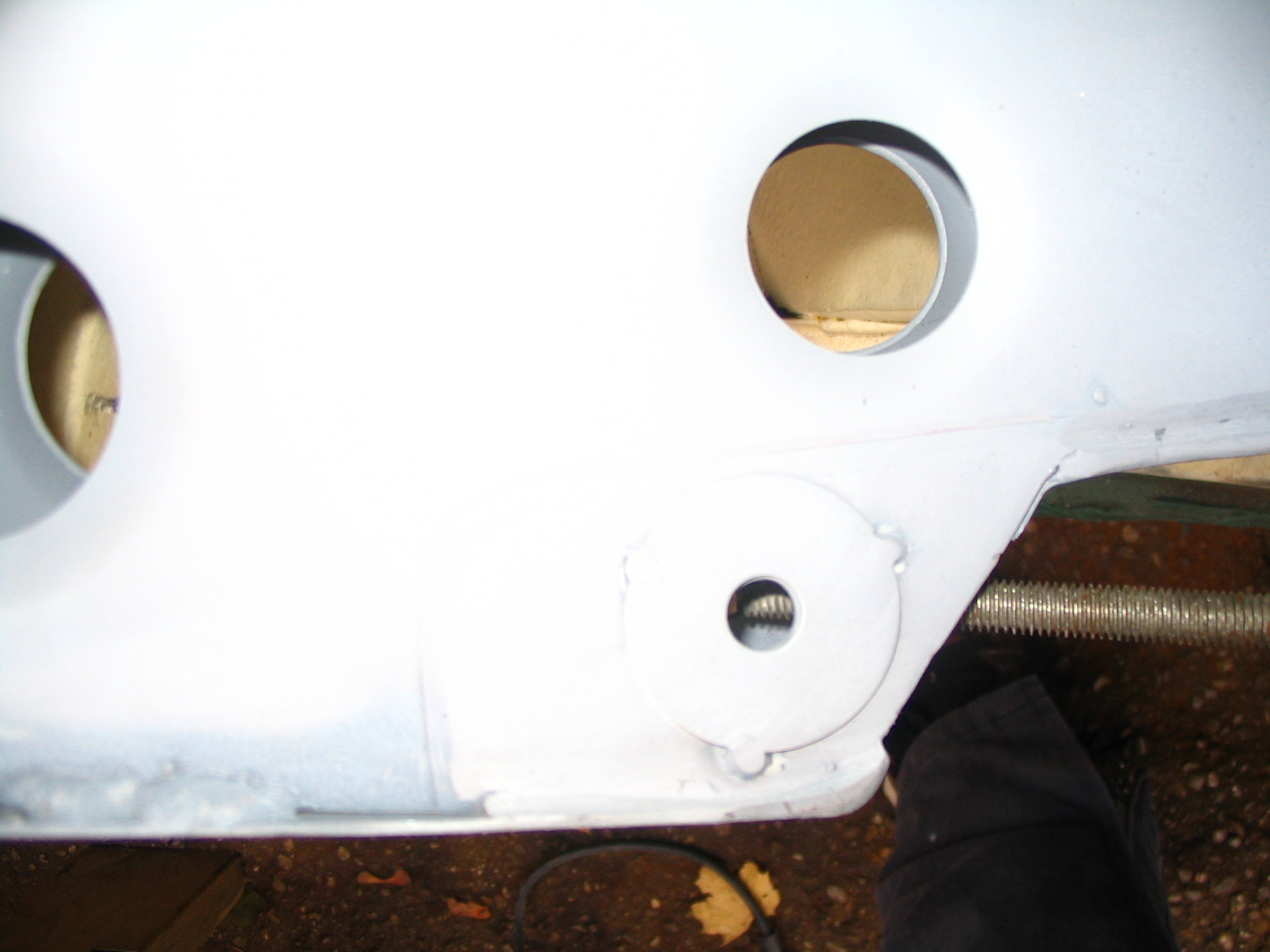

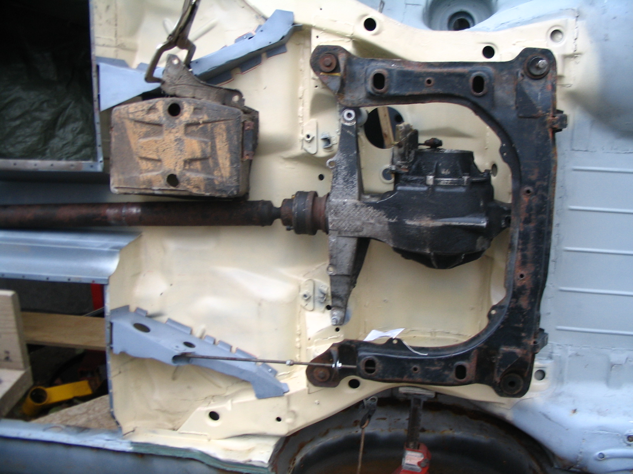

Today I installed a coupe gt front subrame on the rear to make sure it cleared the rear diff..........no problems !!
Next order of the day was to verify that I had my rear control arm brackets in the right position. After some head scratching as to how I
was going to do this exactly, I decided to use some threaded rod. The position of this bracket is really critical. If the bracket is welded out of
position the control arm will bind during suspension travel.
A little video, so as people can understand what the hell I'm babbling about......... http://www.youtube.com/watch?v=2KgC1bxsejI
Also I have some fettling of the battery box in order to fit it in the same position as the road going Sport quattro. It's going to be tight next to
the driveshaft, just like the factory car.
All in all a great day. It might not look like it, but that's a full day's work right there.

- Verifying position of bracket
- IMG_2051.JPG (722.96 KiB) Viewed 40966 times

A few more
- subframe clearance.jpg (302.97 KiB) Viewed 40966 times
- I need to get the battery box over as much as possible to clear the driveshaft
- IMG_2061.JPG (673.73 KiB) Viewed 40966 times

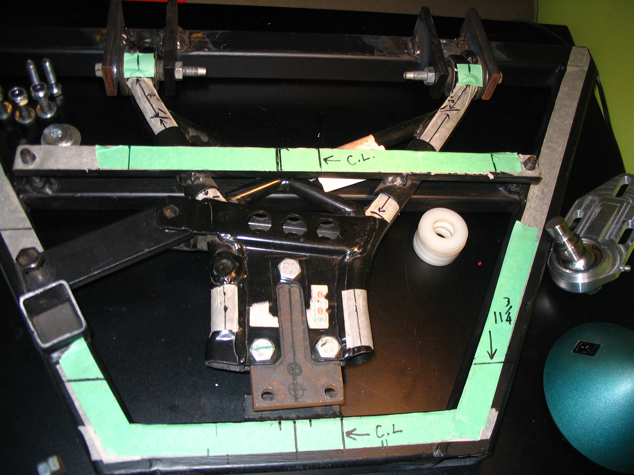

Thanks for the kind word's guys. I'm starting to freeze my bollock' s off now that the weather has turned for the worst.
That's okay, I have so many custom parts to build it's just crazy. Again, Martin to the rescue with his holy grail parts stash
Ed no garage for me...................

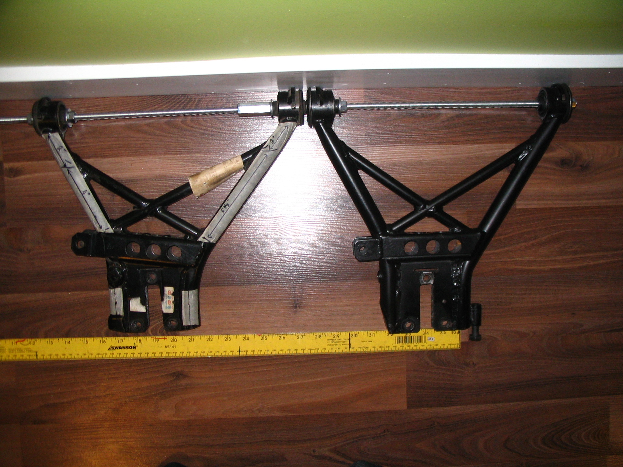

He kindly loaned me his hoard of sport quattro control arms, now I can make my own. I made a jig and started drawing them up in the computer. I'm thinking of making a few different designs.
It would be so easy to move the center point forward thus increasing the caster. I'll have to fabricate a set , and play with the caster specifications. Also I think I'll make a set
to accept a stock 4000/urq ball joint.
Hopefully it all works out. Much nicer working on the computer indoors :-)
Cheers,
Craig

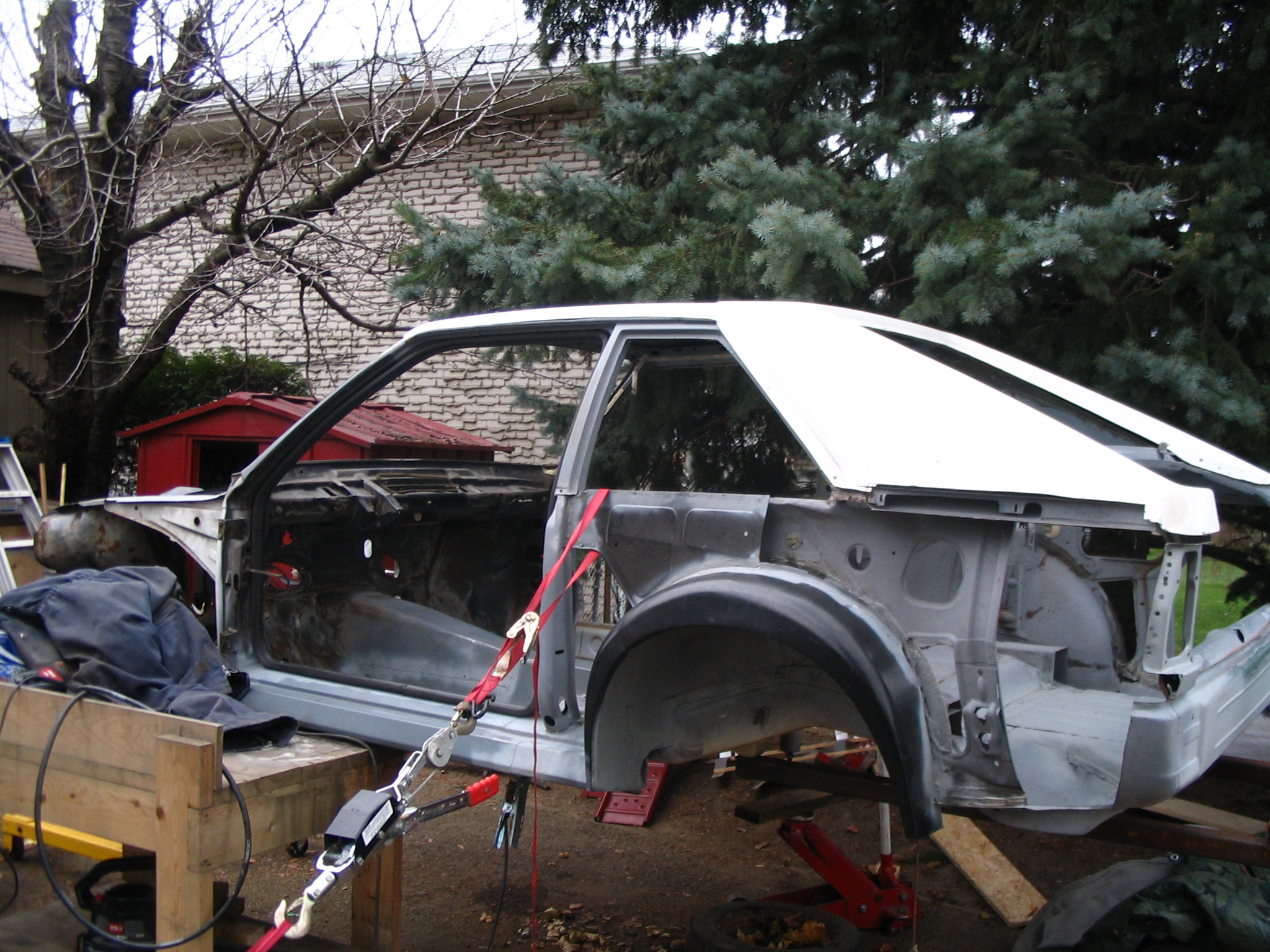

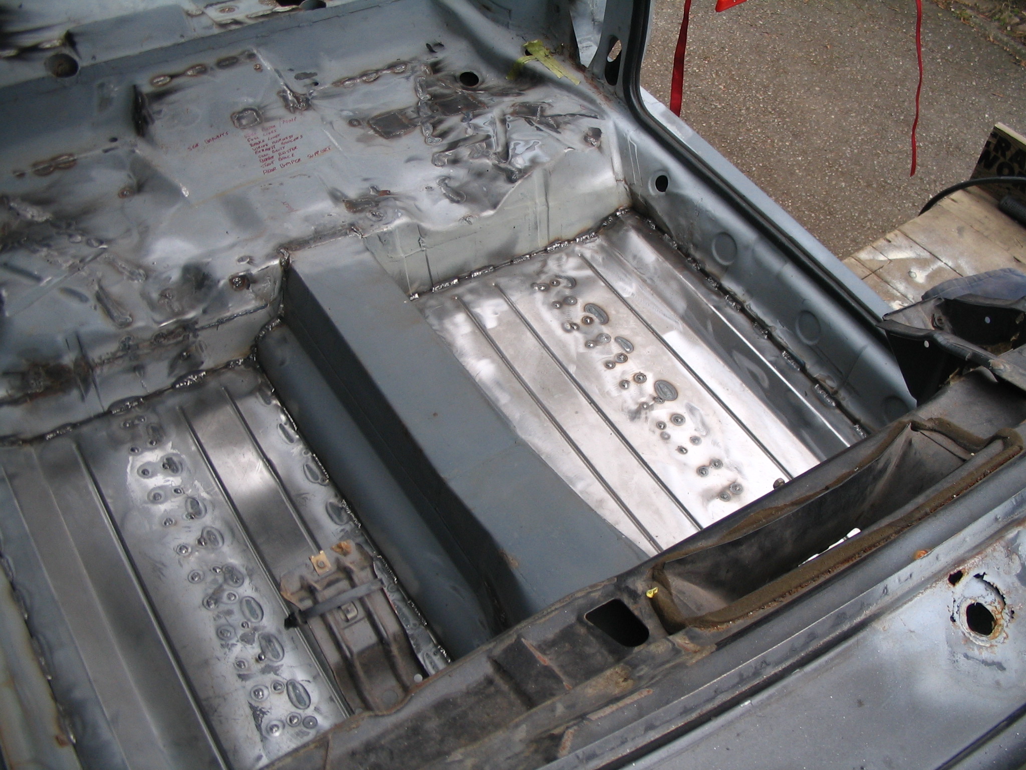

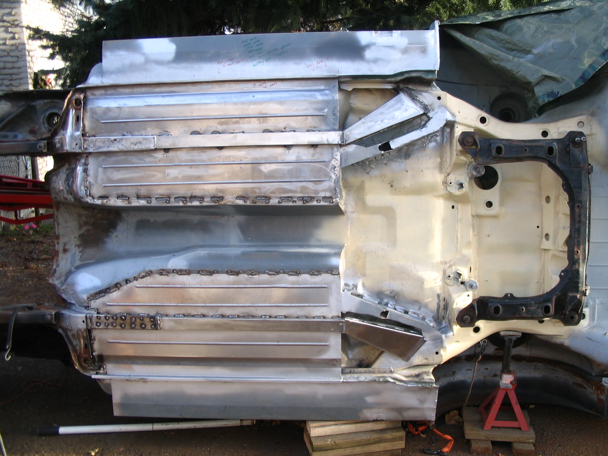

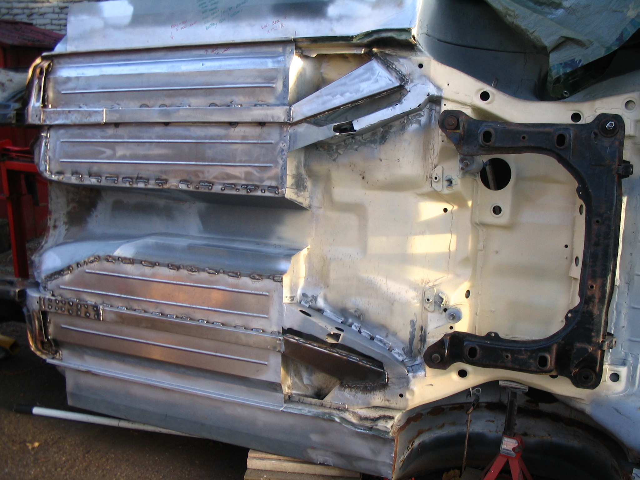

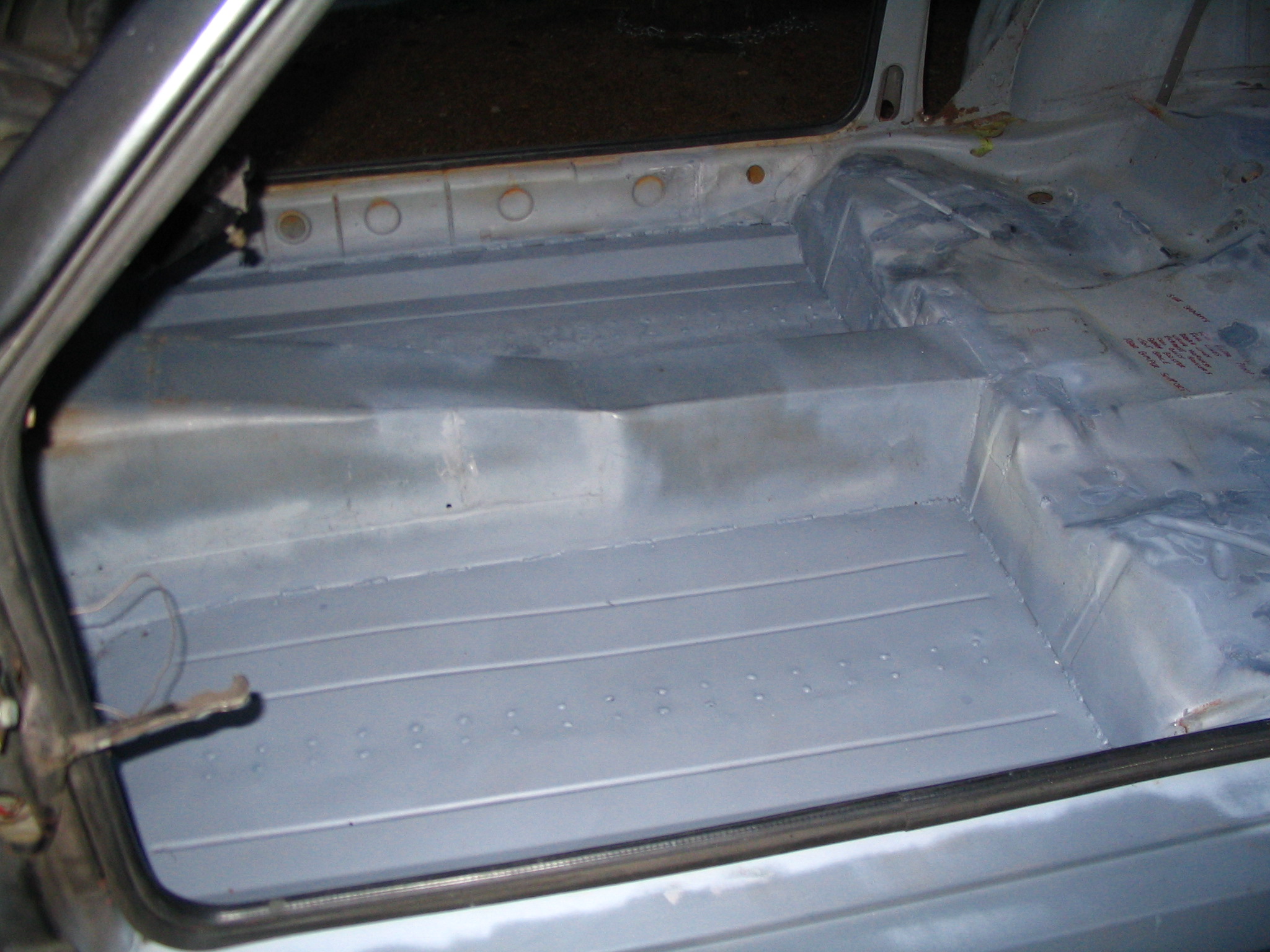

Well today might just be the last day of working on the shell for the year. I froze my bollock's off again. I was even welding in a light snow flurry.........I think it's time to stop
I can say that the floor is almost done. I had a really productive couple of days. I'll probably spend another 29-30 hours cleaning up the floor and making fuel line,fuel pump,handbrake,shift linkage
brackets etc, then I can focus on the roll cage and such. I'm really glad I completely ripped the floor out. It was alot of work for sure, but worth it IMO.
Anyhoo a few pics.
Anyhoo a few pics.
Chris, I use exactly the product that Justin was talking about,weld through primer. Any time I have bare metal to metal contact ,I either paint the part first, then grind the paint off in the weld zone, and then use weld through primer. Once all welding is finished, I then seam seal all joints. Once the final paint has been done, I drill holes where needed, and spray a wax coating to all internal areas where the paint can't be applied.
I used this method on my urq with great results.
Well the weather has finally beat me for this year. Bring on the Canadian winter.
I still have many parts to build over the winter, so all is not lost.
A few pics to close off the year.

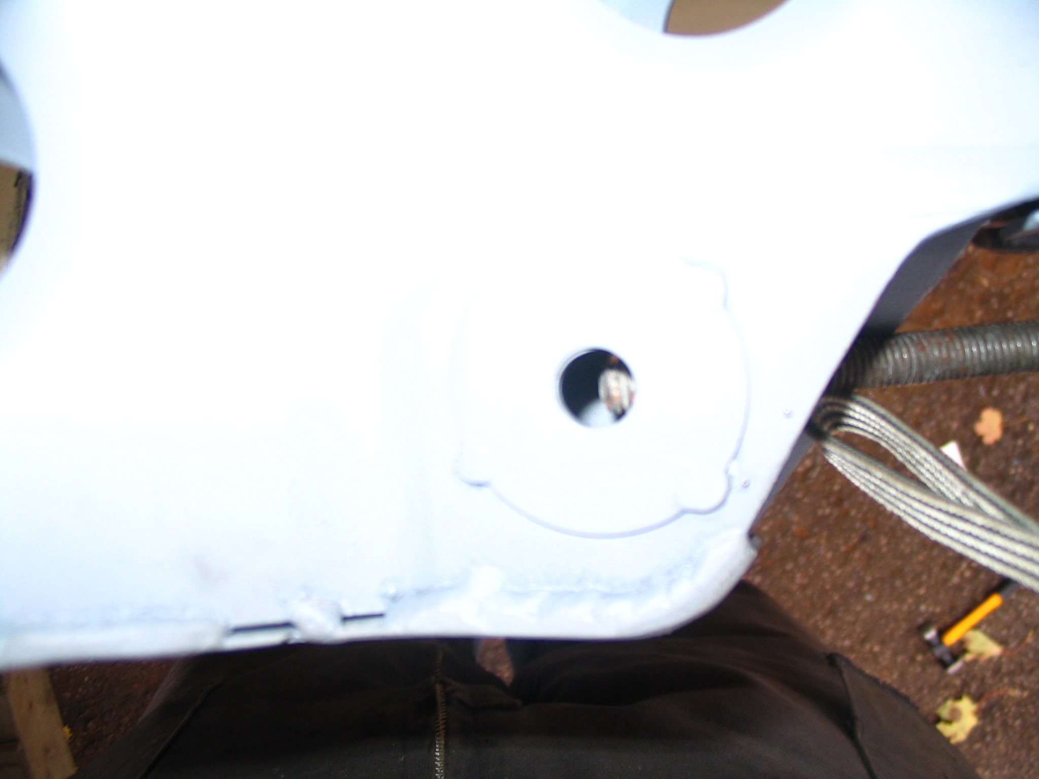

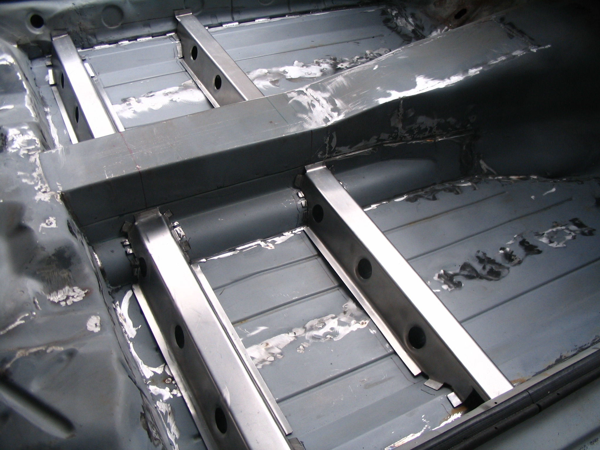

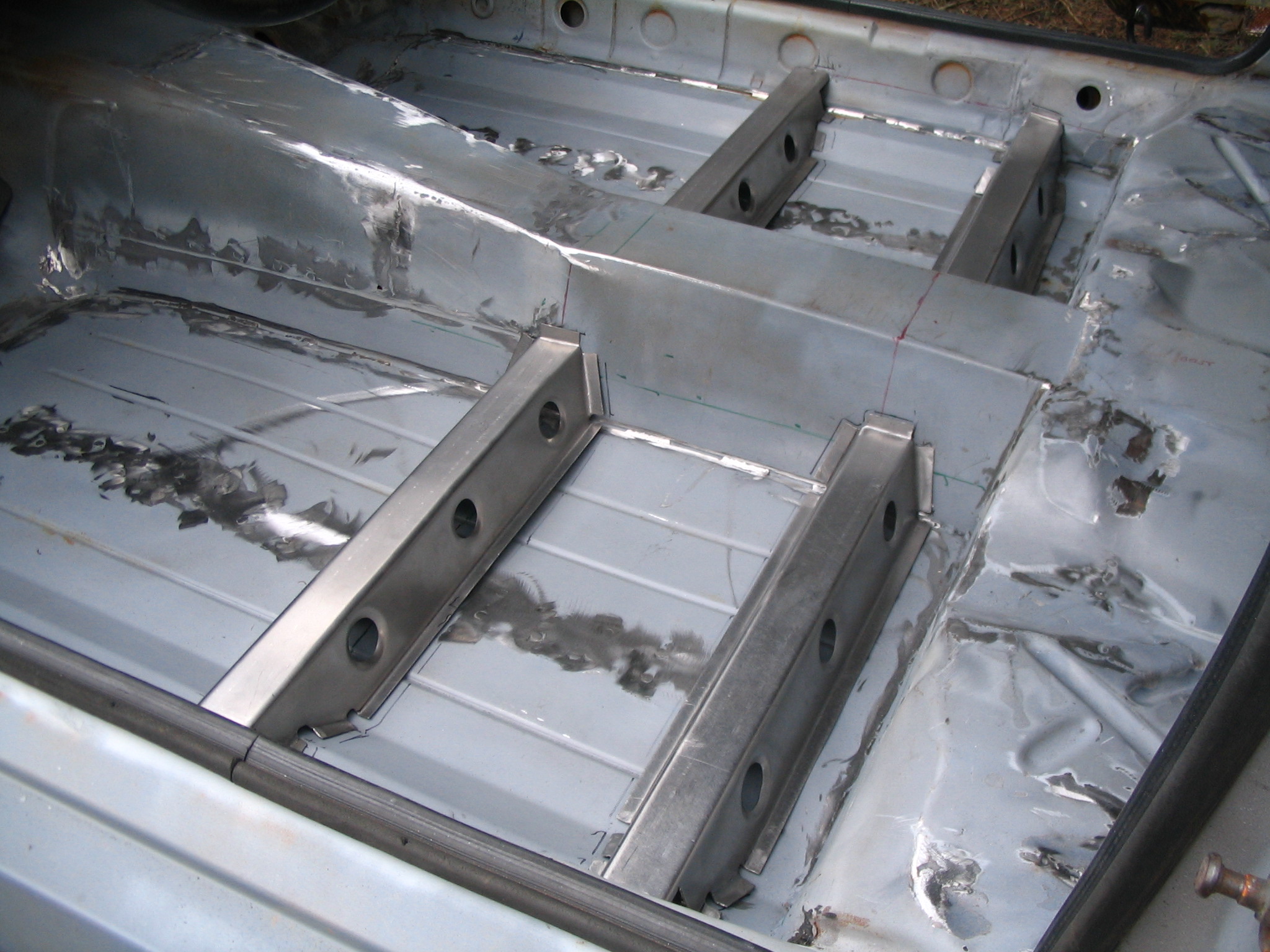

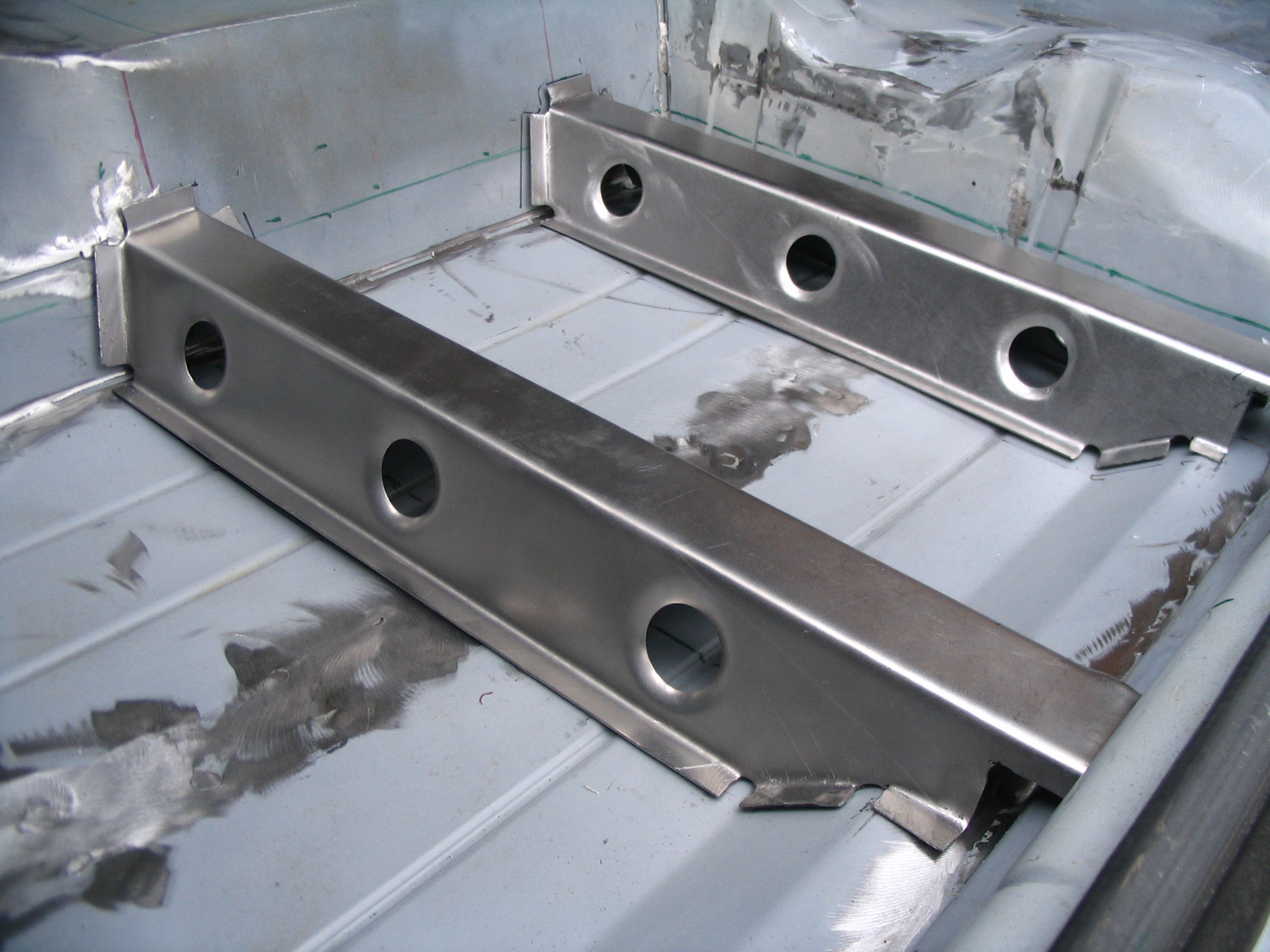

I made these up yesterday.......it's finally spring !!!
Not only will these add strength to the chassis, but I now have somewhere to bolt my Recaro's to.
Cheers,
Craig.
